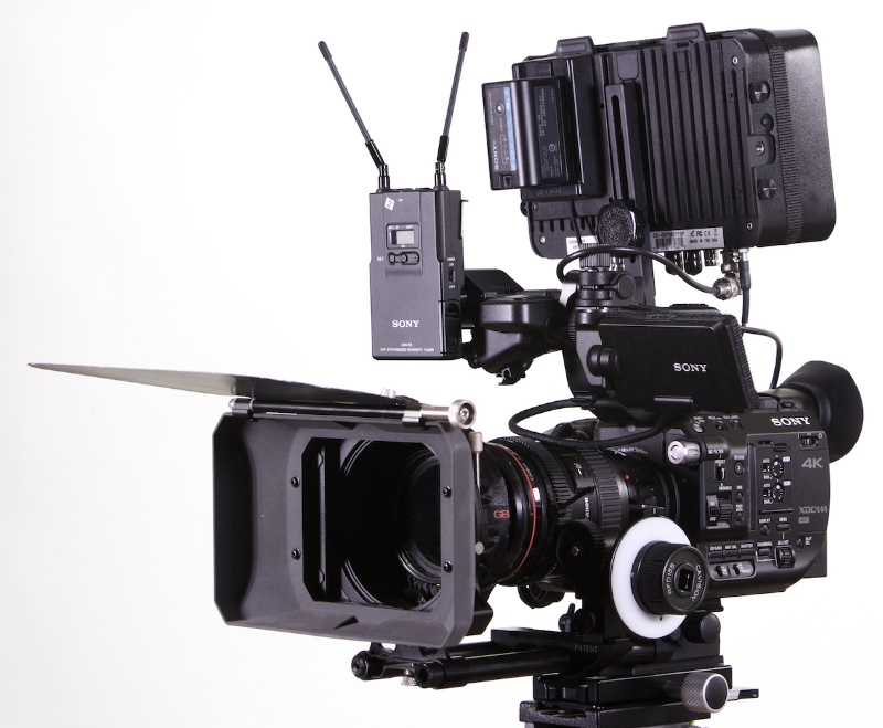

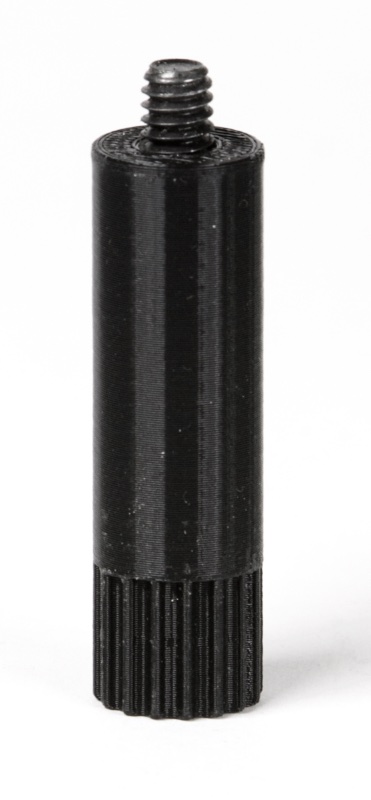

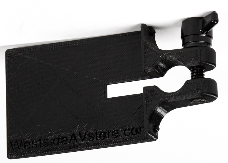

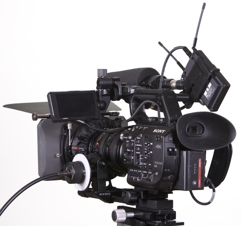

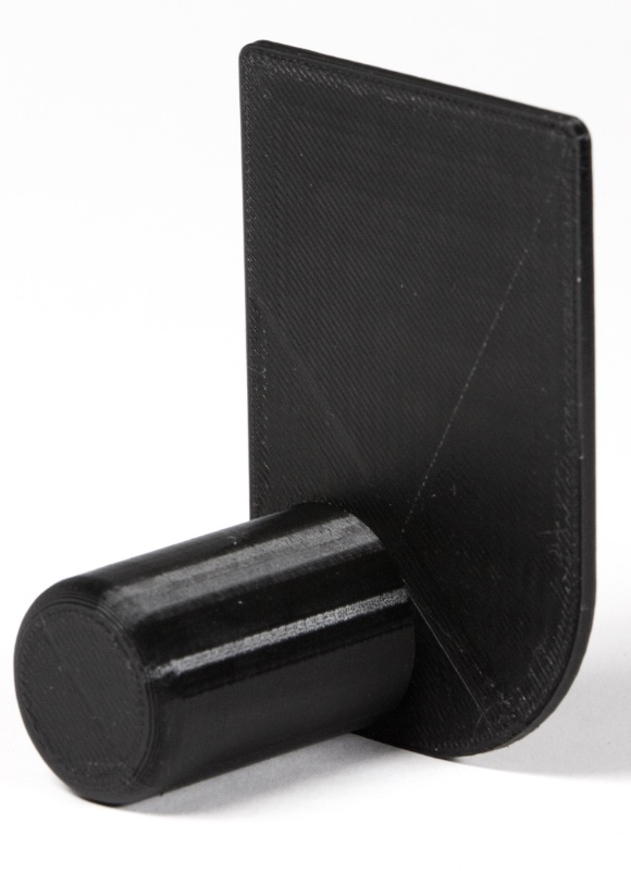

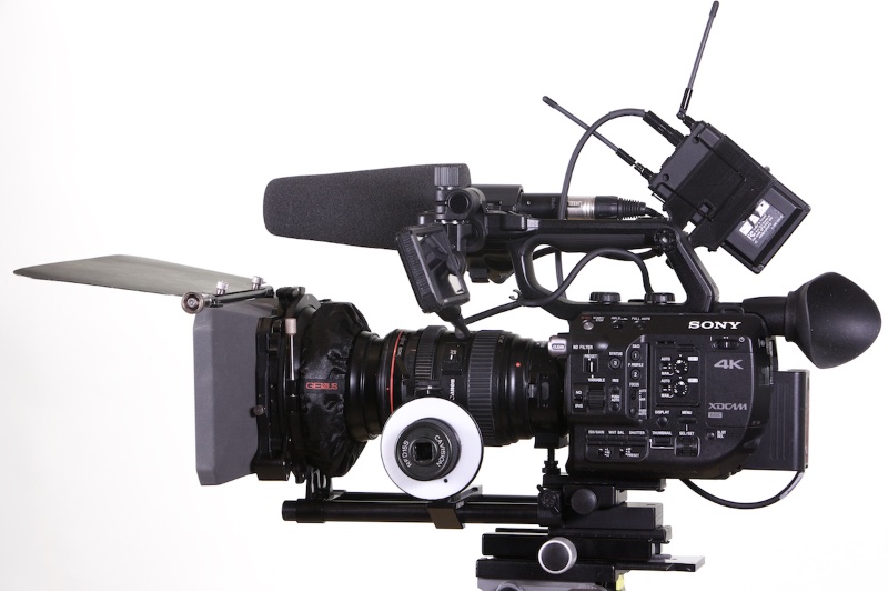

Here are a few ways I do it, I also use shoe mount at times.
These parts are 3D printed...
