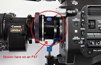

I own the 18-110 but there is no way that this lens is suitable for serious football or stage entertainment at distance for a variety of reasons. a, It's not long enough even with center crop engaged, b. You need a professional ENG/EFP zoom capability to cover team sports / motor sports efficiently and c. While it does have decent focusing it's not quite in the league of a good B4 lens.
Seriously If you don't need to shoot in 4K the FS7's Super16 Center Crop function works very well with a quality adapter like the MTF B4 to S16 adapter. It's optically and CA corrected to use three chip lenses on a single S35 sensor. It's sharp to the edges on a decent HD B4 lens and even on the last of the very high end SD lenses. Lenses that cost upward of $25K that can now be bought for around $2.5-5K. The adapter will give you a crop of just on 1.32 so an 18x B4 gives you a very useful 23.76 long end. A traditional 22x ENG lens gives you a whopping 29x. Good for most sports. You will lose 0.8 of a stop in light loss but that's no big loss on an FS7 with an ENG lens that is typically f1.6. At minimum all you need to drive the setup is a 'D' Tap to 12 pin Hirose connector to power the lens. There are other cables out there that do this plus allow record stop/start from the lens or a zoom demand by connecting via Lanc to the FS7. Used in combination with quality B4 zoom demand shooting sport and entertainment is so much easier.
The end result is that you end up with a constant aperture lens of about f2.3 that is parfocal and that has a fantastic broadcast quality servo zoom that has enormous reach. I've used this combo on numerous broadcast sport and entertainment shows and the clients have loved the images. I've been totally happy with the results. Sure it's not a Fuji Cabrio but the image quality is quite surprising and for the price very hard to beat. Expands the FS7's versatility considerably.
Explanation of how the adapters work work:
https://www.bhphotovideo.com/c/product/1197319-REG/mtf_services_ltd_mtb4s16sem_b4_2_3_to_super16.html/BI/2855/KBID/3801
A stage sample mid shot using an 18x with the MTF S16 adapter. Shot 1080i for BD and DVD:
https://www.youtube.com/edit?o=U&video_id=hj3wOzL1Y-Q
Chris Young
Sydney

Chris,
That looks like a great setup. I need to rent one for my next sports shoot.

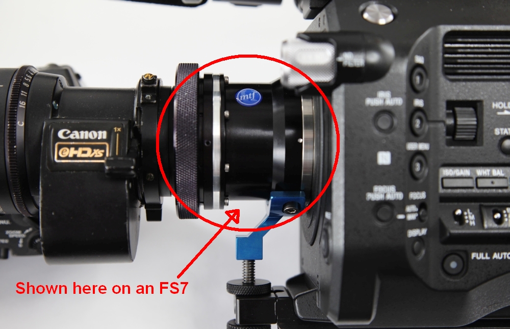

Using B4 lenses on the Blackmagic Studio Camera - YouTube
Newsshooter at IBC 2015: MTF - B4 to Sony E-Mount adapter on Vimeo
Chris Young
Sydney

Paul it works surprisingly well and overall the price/performance/flexibility ratio was a no brainer from my point of view. It's allowed the FS7 to be used on many jobs that previously couldn't be covered like power boat racing and our Bells Beach National Surfing Championships. Over crank surfing shots being one thing the older XDCam disc cams couldn't do.
If you are interested from the technical point of view this is what I have discovered with the Sony center crop mode.
Sony’s Super 16 crop sensor dimensions are 12.7mm x 6.75mm for 2178 x 1148 which results in a diagonal of 14.5mm, a fair bit larger, 32% larger than the 11mm diagonal of a 1920 HD sensor. 2178 x 1148 gives us total of 2,500,344, a resolution of approximately 2.5K. The generally accepted figure is a Bayer sensor loses about 20% of its resolution after demosaicing. For example a 4K single sensor has a resolution of 3.2 K a 2K sensor has a resolution of 1.6K and a 1920 sensor has a resolution of 1.5K.
Based on Sony’s Super 16 figures of 2178 x 1148 the center crop function results in a 2.5K crop. One could then argue the following. After applying a 20% loss in resolution after demosaicing the image produced is in the order of 2,000,275. Very close to 2K in other words.
BTW you can now buy the M4/3 mount for the S16 adapter as an extra. It comes with all necessary screws and it is then just a simple screw driver swap job if you want to use it on a BM S16 sensor camera. I think some guys have even used it on the GH series cameras in crop mode. What kind of crop results you get I've not followed up.
