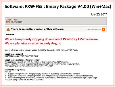

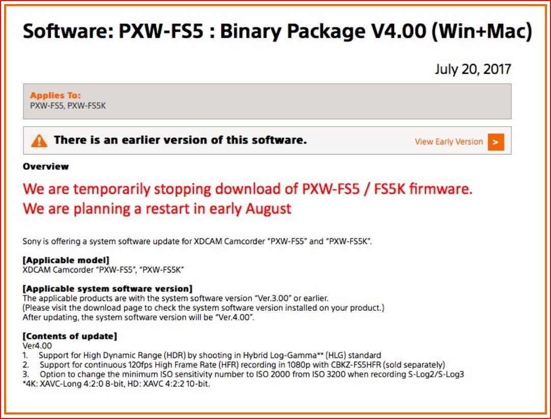

Haven't been able to confirm this yet but check this out. maybe best to hold off till this situation is clarified.
HD Warrior » Blog Archiv » Meanwhile back at Sony…FS5 firmware V4 has been pulled with no explanation.
Chris Young
CYV Productions
Sydney

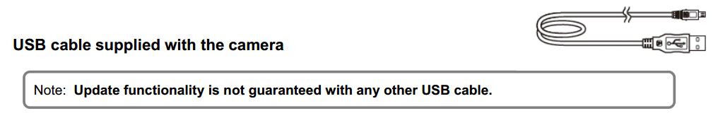

Just had a thought. Are you 100% sure you are using the USB cable that was supplied with the camera. I have seen a couple of cases where another USB cable was used and the update wouldn't proceed. I notice with the FS5 upgrade instructions they don't specify that you MUST use the supplied USB cable. With a number of the other Sony cameras they specify to use the USB cable supplied with the camera. Sony goes on to say that
"Update functionality is not guaranteed with any other USB cable."
As I say just a thought. See below the warning from an X70 uograde.
Chris Young
CYV Productions
Sydney
FS5 does not detect AC adapter preventing me from firmware update-usb-warning.jpg
