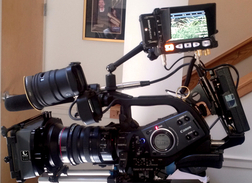

So...we're new to our Pix240 but love it.
Using our Canon XL-H1 (original version..no audio down SDI)
Anywhoooooo....
The LANC connection does not work with Pix. It controls a remote zoom...but will not start/stop the Pix. Anyone else run into this with their H1 ?
Now...Timecode...
We have the TC output of our H1 connected to the TC input on the Pix. Record start/stop is being triggered by the TC.
On the Canon..we're shooting 24 fps. 1080 of course. We have the Pix set to AUTO input fps. The video setting is set to 1080 59.94.
When we record HDV tape and Pix at the same time....the time code does NOT sync. We 've done the jam sync on the Pix....but they drift. If I record 30 seconds or so...the tc drift on the Pix is about 3 seconds FASTER than the HDV tape.
What do we have set wrong ? Ideas ?
Thanks !

Re: timecode issue
Kevin,
Is the difference a fixed offset or a slowly increasing difference?
If it is an offset, sounds like the XL-H1 is sending code out of the output that isn't in sync with what is being recorded.
If it is a slowly increasing difference, you have an error in your frame rate settings. In a situation like this, usually one box is set to 29.97ND while the other is set to 29.97DF. Or, one is set to an integer frame rate (24/25/30) while the other is set to a non-integer frame rate (23.976 or 29.97).

Re: timecode issue
Thanks for the suggestions Matt.
Actually it was a simple fix. Our lanc will not fire the pix into record start/stop.
We had the pix set to record when it saw the tc begin to run. I believe we had the TC input set to start /stop. It needs to be set to external (the camera supplying the tc as master and the pix as slave.)
that fixed our drifting tc problem !
