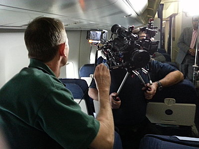

Attached is a picture for a shoot I was on the other day. The rig was rented from Zacuto, Dionics powered the whole thing, camera and PIX. Joe, the AC, was using the PIX with FocusAssist for critical focus on the Zeiss Primes.
Rail systems really seem to be a matter of taste, there are just too many ways to do it.
The other possibility would be an Anton Bauer Dionic mounted on one of their belts:
Anton/Bauer - Products - UNIPAC
The NBA used these with the PIX mounted to the belt, so the only connection from camera to belt was the BNC (they were shooting VariCams, HDX-900s and other full sized cameras.)
