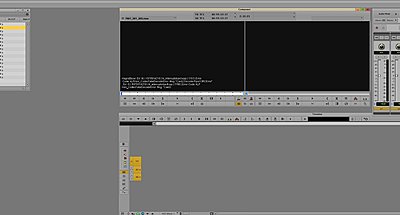

Well...this isnt' better.
Tried to import Avid 220 dnxHD from Pix. Did the import fine Put it into the source window...and this is what I got ! Nice............

Ouch. I know this is an old thread so I feel a little wrong for bumping it, but has this ever been resolved? Does any other recorder with DNxHD QT modes exhibit this issue?
Old September 15th, 2016, 11:34 PM   #6
Location: Burnaby, BC, Canada
Posts: 3,053
Re: Avid Codecs not very good.
Bumpity bump.
Just learned the AJA Ki Pro Rack recorder without the artifacting issue only records to HFS... Boo. So did this "artifacting" issue ever get resolved? Cause a FFmpeg rewrap could be all that's needed to fix compliance issues.
