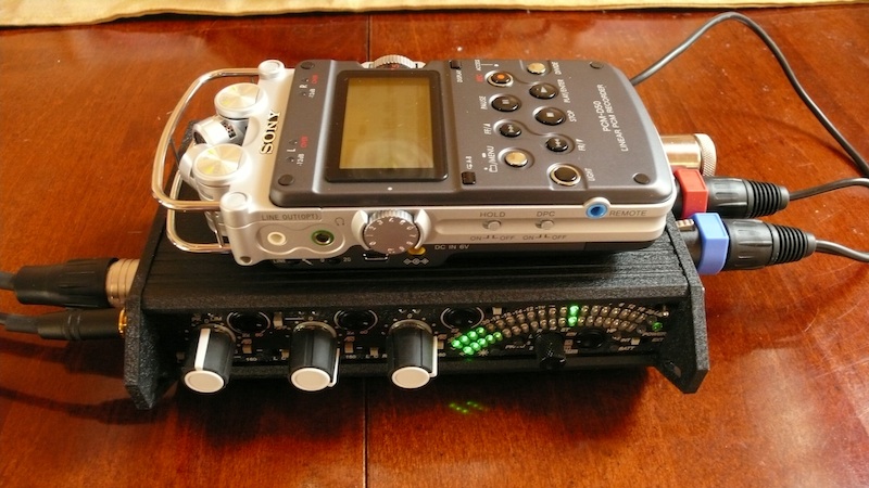

I shamelessly snagged this image from a different web site.... I'd give credit due but don't know the name...
here is the Sony PCM-d50 with the SD302....
