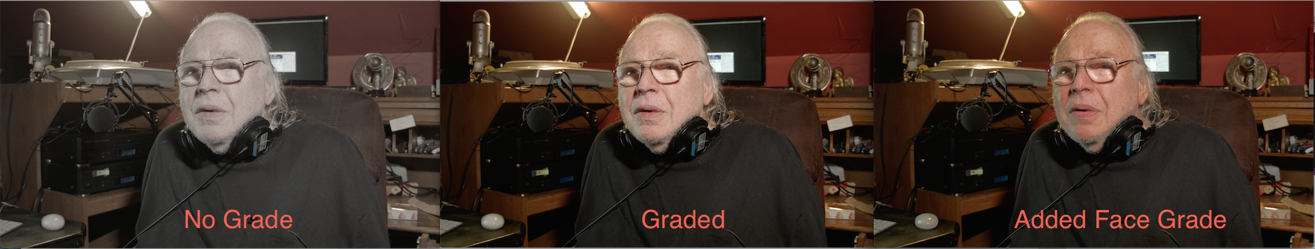

Had a shoot in the tightest of spaces. Usable area might have been 4' x 4' (1.2m x 1.2m) at most!
Had BMPCC and lenses in a smal LowPro backpack. My too heavy Sachtler tripod in its bag (still need to decide between Aero4 and their SF6 Carbon leg tripod). In a 32' PortaBrace bag I had two light stands, two Digital Juice Miniburst 128s and one Airbox inflatable soft box and my Sennheiser Wirecast EW100G3 Mic kit.
I used BMPCC with Lumix 12-35 set to 12mm and f2.8. I'd have used a Sigma 18-35 with SpeedBooster if I had the lens instead for a bit shallower DOF. I could have used a Nikor 20mm f4 lens with SpeedBooster which ultimately would be a little faster than the Lumix (would have been about as wide).
I had to do a "wrong side" key light since there was no room to place a light on the proper side. I tried the Airbox with the light at 4 o'clock but with no fill light it looked odd. Instead I moved the light right next to the camera at 5 o'clock without soft box so, ultimately, the face looks flat lit. There was an opposite side practical which worked as a bit of a hair/accent light.
The tripod was just outside the door. Just enough room for me to stand without falling down the stairs behind me. Yes the entire space was that tight.
Left is straight from camera shot ProRes LT. Middle is Grade in FCPX. He looked pale especially against the rich earth tones in the background so I did another color filter with color selection on face and graded that so he looked a bit more flush. BTW I was bothered by the white box on the monitor behind him but to change that we'd have to had cleared out of the room so his engineer (he's a an overnight radio show host) could change it. We determined it wasn't worth the interruption and delay. He was going on the air at midnight and we weren't able to start the shoot until 10pm.

Old October 17th, 2014, 07:02 PM   #54
Join Date: May 2003
Posts: 594
Re: Subway Kit and the Tripod Quandary
craig-
wonderful description of your workflow.
it always makes good reading to see how others deal with the issues of production.
i thought the face grade version was far superior.
nor was i bothered by the monitor.
in fact, it offered another layer of separation from the background.
if it was there, you would have wished it was!
thumbs up.
be well.
rob

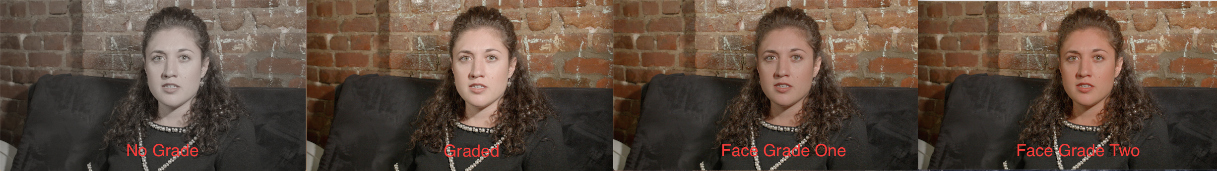

Small Living Room. Same Gear as above. There was about 4' from couch to wall and about 10' long.
Shot at f2.8 with Panasonic Lumix 12-35 lens at 12mm.
Two Digital Juice MiniBurst 128s. Key Right, Fill Left. Shooting on angle so I could increase my distance to the couch. You can see the bricks going slightly soft as they recede on the left. There was no room to move her away from the wall. Even closer to wall than previous shoot.
No Grade on Left, Basic Grade Left Center. Face Grade One Right Center, Face Grade Two Right which might be slightly too saturated and dark. Probably going with Face Grade One Right Center.
I did a color selection on the face but color was close to the brick which was also selected so I also did a shape mask to preserve the bricks.
You can see the kind of crazy cramped conditions I often shoot under and why I need a small SPC Kit.
