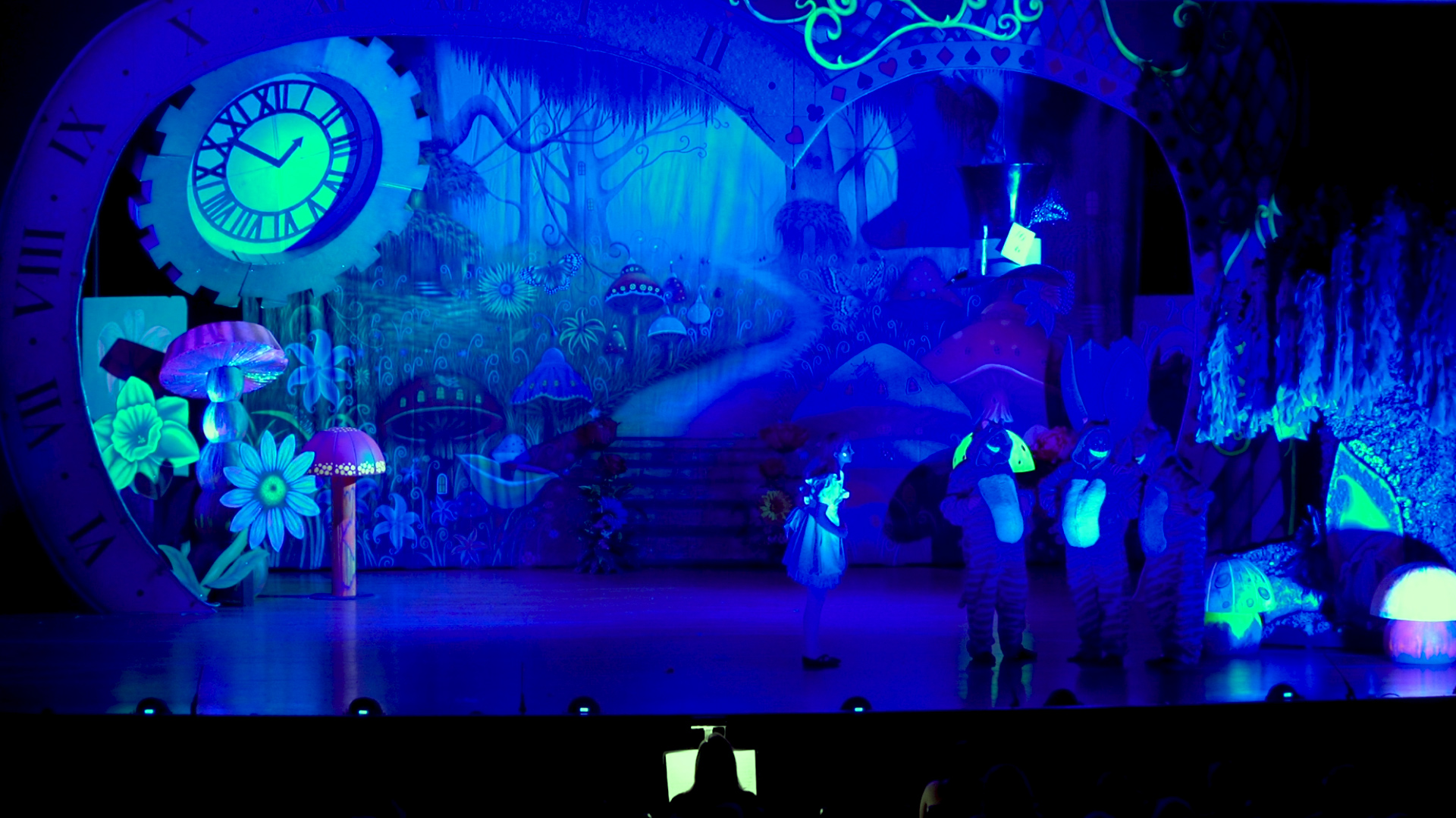

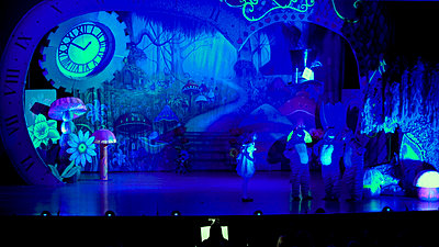

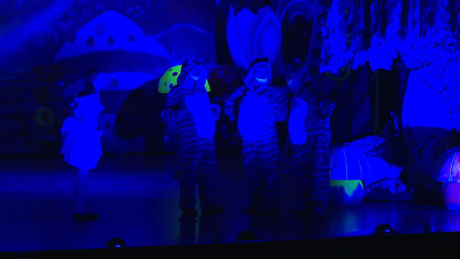

Thank you Paul for your example.
Here are two screen shots of the same moment when the stage lights went primarily blue. One is even more extreme than the one you shared. This is what I was trying to avoid.
John
How do I get around terrible theatre/theater lighting?-cats_ws.jpg   How do I get around terrible theatre/theater lighting?-cats_cu.jpg

Ah - you discovered the other problem/benefit. The LED blue makes things fluoresce - the blue content extends into the UV area, so unexpected things happen with fabrics and paint. We have a scenic painter who comes at the last stages of rehearsal and touches up the scenery and large props that frequently suffer from the trucking process, and one lovely old fella is very old school, and amazingly talented - unfortunately, they paint in white light, and one of his colours in his touch up kit fluoresced - so as soon as the lights went blue, all his splodges and twists lit up like this!
That's not a camera issue at all, it's one of the hazards of the Blue - and they've even done it on purpose now they know, they've added an extra LED emitter that deliberately adds the UV-A end of the spectrum, making this 'feature' worse. I do lots of dance school shows and when parents source their own material because it's cheaper, their kids often stand out, as the selected fabric that might be expensive does or doesn't fluoresce, but the cheaper alternative is different, but often exactly the same colour in white light.

But you can't avoid it. The camera can only record the light that's there. If there's no green or red light reflecting off the faces (or anything else), there's nothing for the green and red photoreceptors to record. You can tell the camera to show you more green and red, but twice nothing is still nothing.
That's just the laws of physics talking to ya.
Under less extreme lighting, the human eye/brain visual system can make things up, see what's not there, fill in some of the blanks. It knows that's a human face, it knows what skin tone looks like, and it can see skin tone when there's no skin tone present.
But a camera is not a human visual system. Not even close.
