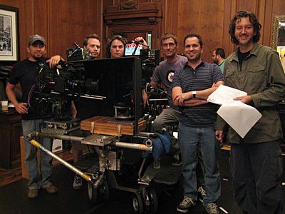

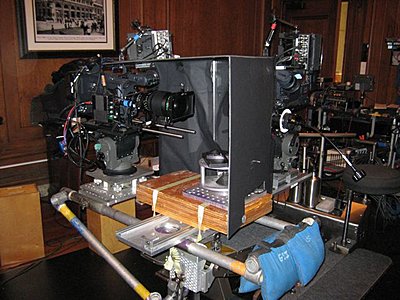

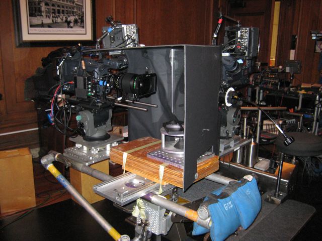

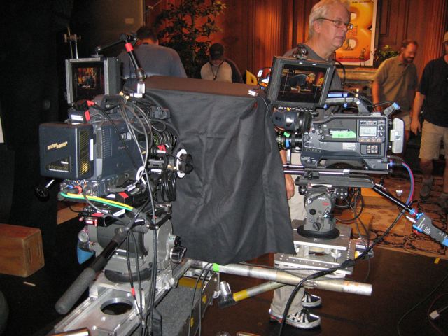

This week I was posed with the request to shoot simultaneously wide and tight angles due to a tight shooting schedule that precluded doing them consecutively, so I came up with the rig seen in the attachments.
It incorporated a half-silvered mirror (rented from Clairmount Camera, generally used for 3D rigs) and the rest was assembled on the day. Both cameras could pan and tilt independently, and the entire works was mounted on a Fisher 10 dolly so we could do moves. The idea was that they could cut from wide to tight at any time, with the talent (Jerry Seinfeld) looking into the lens the entire time.
Definitely not your normal shooting rig! It worked perfectly, though. The B camera image was flopped left-to-right which will be fixed in post, but it appeared sharp and none the worse for wear having been shot via a mirror.

We needed to have Jerry looking directly into the lens on both angles, thus the cameras needed to share the same optical axis. If the cameras were side by side, one of them would have a slightly off-axis eyeline. And since they needed to pan and tilt independently, the distance between them would have been a good 8 inches (which translates to more like 12" between the center of each lens) so this would have been noticeable.

This is effectively what we were doing, but slaving one camera to the other operationally would not have worked as the compositional needs would have been compromised.
Had we had access to a 4K camera (and plenty of tracking time in post), we could have cropped into the image to create a tighter size from that. But with HD delivery part of the deal, this was not an option.
