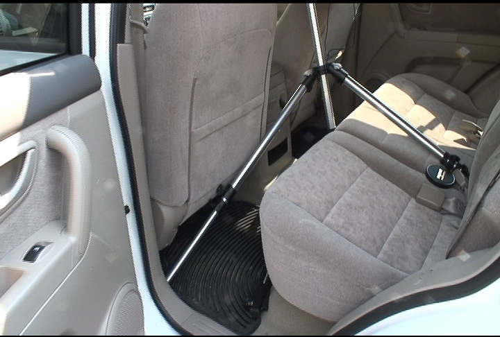

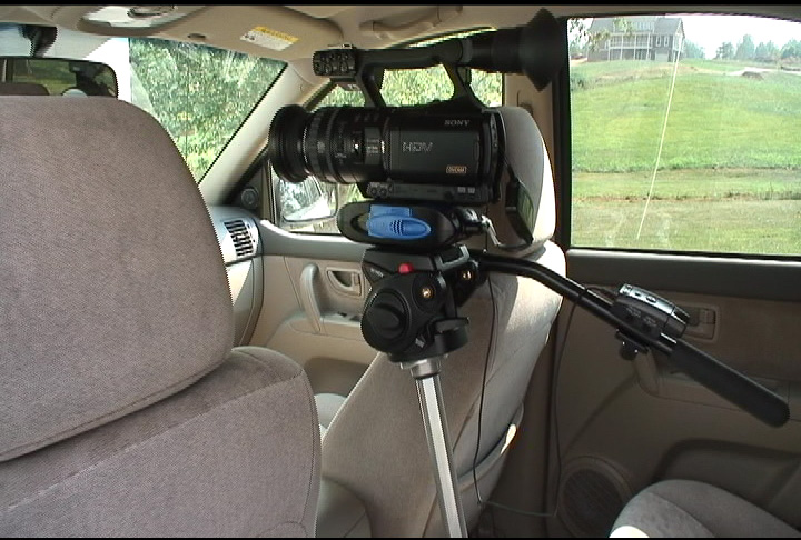

I've shot over 40 hours of trip video from the car for my weekly TV show "Rapid Ralph Runs the Roads." After much experimentation, I've found the PERFECT car mount, a TRIPOD! My Bogen/Manfrotto tripod with 503HDV head mounts solidly in front of the back seats (and people can even still ride back there). It bonds nicely with the car's harmonics and offers all the security and other advantages of having your cam on a tripod (I use a Sony V1U). For an example in action, watch the first five minutes of
http://video.google.com/videoplay?do...42494325&hl=en
It's from another show I do. ... and see the attached pics of my setup.
--Ralph

the pics from the previous message in jpeg format.
and the intro to "Rapid Ralph Runs the Roads" which shows the mount in action:
http://youtube.com/watch?v=ktjORIYlIJU
