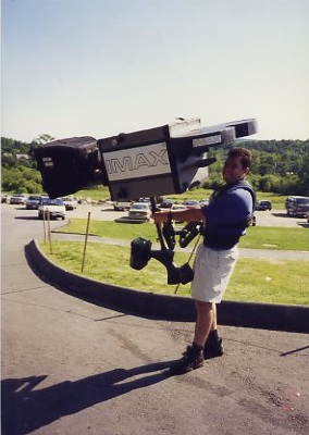

Not quite a Genesis on a Flyer--but theoretically, the same general camera to sled ratio...
(I'll make no further comments about this picture just yet)

2 words - low mode!

and I'd imagine that the side-side balance is easy to maintain with those mags!
Hmmm... makes me glad that IMAX job I was called about a few years ago didn't happen.
LOL Need to trim during the shot as well!!

when did chimera get into the matte box bidness? hehe.
