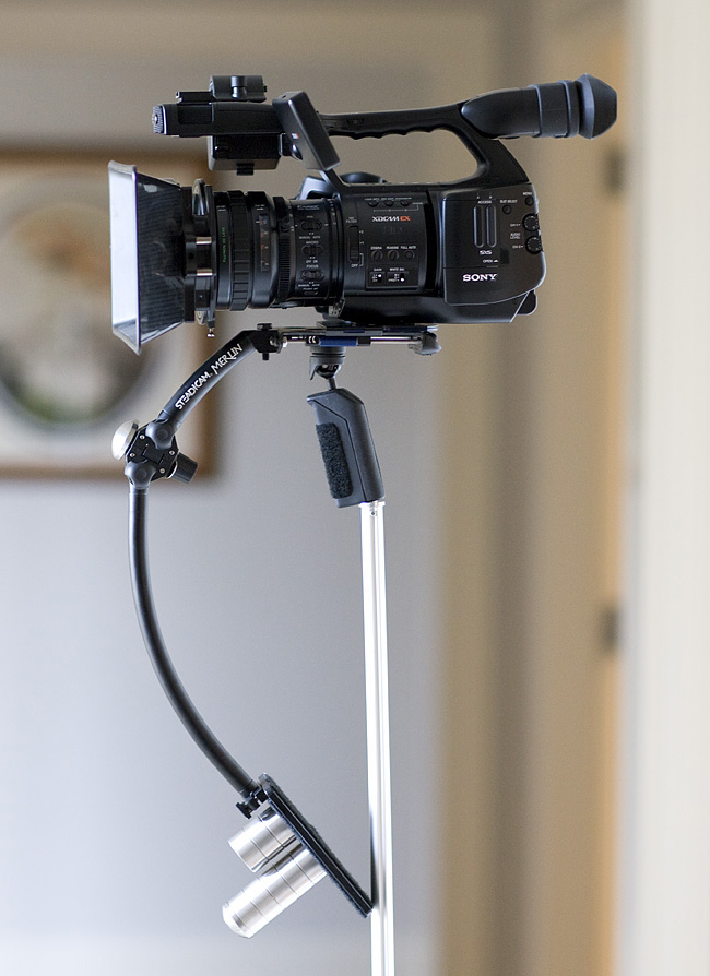

We have been trying for several to get teh EX 1 balanced now for several hours, if you would be so kind to share with us the settings you are using on the merlin and where you have the weights at that would be very much appercitated.

sure... the liftgate on my sequoia is frozen shut and I can't get to my gear right now..... but I'll take a snap of it and post as soon as I can. but basically one mid weight, and 6 bottom weights on the accessory plate, and spar all the way extended..... I think.

ok... sorry for the delay.....
here's a pic as I fly it ( sans the vest/arm )
if I attach a senn G2 receiver, I remove a few weights until it's back to level.
