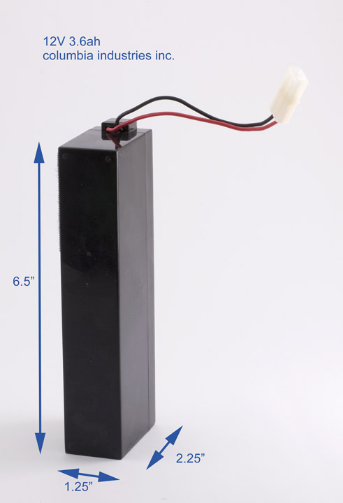

while you guys are searching for a replacement beryllium sphere... I've discovered a 12v 3.6ah rechargeable battery at walmart in the kids toy department. it comes with a charger and is 1.5" X 2.25" X 6.6" in size...
Beryllium spheres - reminds me of The Shadow with Alec Baldwin. LOL.
Is your Wallmart battery anything like the Tamiya battery used in the Fostex FR-2LE? The dimensions seem about right for that, and they also seem to be popular for radio controlled cars. Was there a connector on the pigtail? Did you see any 7.2v batteries while you were there? Maybe we've found a new source for all our battery needs!

I've googles the hell out of this batt and can't find anything about it. they are made by columbia industries ( didn't they invent the dry cell liked a hundred years ago? )
but.... they work. and correction about my previous post. I put a female 4 pin xlr on the end.
ill post a pic when I get home.

here it be....

Looks a lot like the Tamiya battery for the Fostex FR-2LE.
See here:
http://www.fostexinternational.com/d...FR2LE_OM_E.pdf
page 21.
Did it have a 2-pin Molex connector like the one shown on page 21?
Also, what are you using to charge it?
Dave Gish is offline   Reply With Quote
Old February 11th, 2008, 03:12 PM   #37
Location: Louisville, KY
Posts: 591
yep... same connector.
but... this bat is 12V 3.6ah
and comes with a wallwort charger....
Christopher Witz is offline   Reply With Quote
