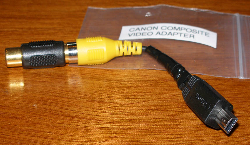

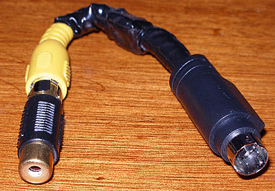

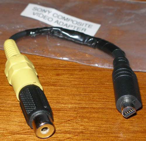

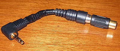

Composite Video Adapters
Composite video adapter cables:
1) For Sony EX1, V1U, & other Sony cameras
2) For Canon 7D
3) For various Canon cameras (including 5D)
4) SVideo to Composite Adaptor (uses small capacitor to combine color with block/white image)
Steadicam Pilot - Getting Started Q & A-sonyvideoadapter.jpg   Steadicam Pilot - Getting Started Q & A-canonvideoadapter.jpg
Steadicam Pilot - Getting Started Q & A-canonvideoadapter2.jpg   Steadicam Pilot - Getting Started Q & A-svideocompositeadapter.jpg
