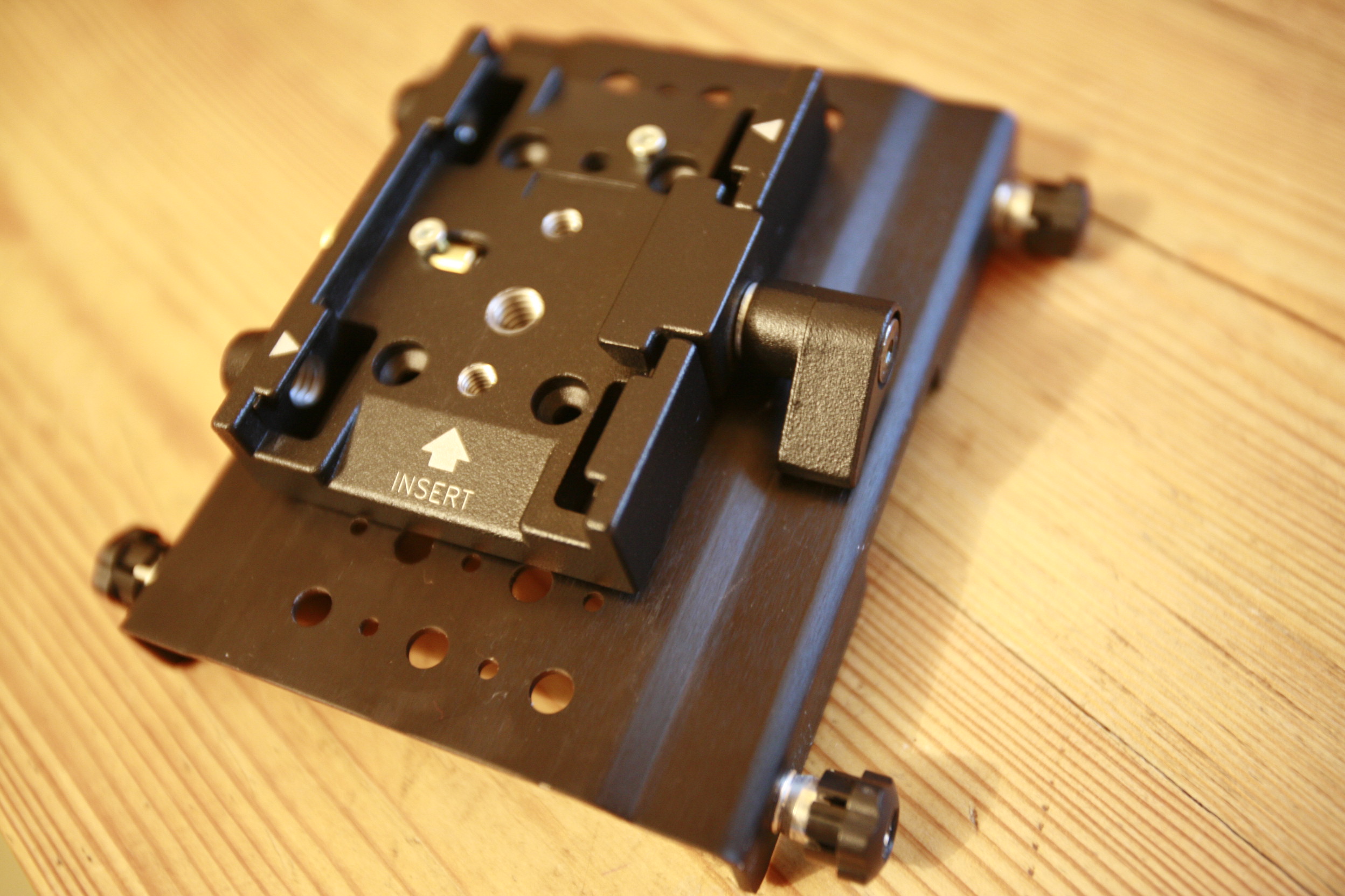

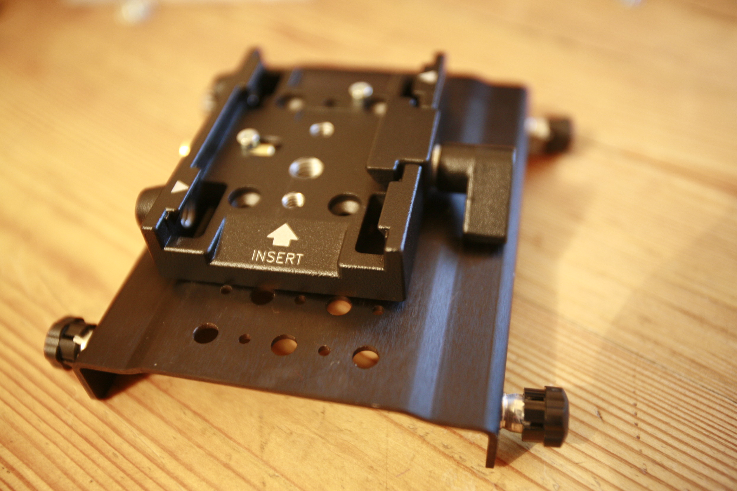

My steadicam pilot arrived today, together with the bogen adapter. Anybody knows how to attach the adapter to the stage?
THe holes in the stage aren't wide enough...

I'm forced to attach the Bogen adapter slightly off center towards the right, because of the lever. It cannot rotate otherwise.
So, consequently, the camera is also slighty out of center. The finetuning knob cannot compensate this.
Any suggestions...?
Any suggestions...?
Eugene, see my picture up above. I had a metal shop make that for me. I then had them shorten the height to half of what you see in that picture. But it works very well.

My Z1's cg leans to the right because of the shock mount, microphone and windjammer so I mount it to the far left side of the plate and it works out just well balance wise, and I can just turn the lever by slightly pulling it out first and then turning it.
As you Nick, I have to mount the bogen adapter to the left onto the stage (because of cg of my Canon XH A1)
There's no way I can rotate the lever, even when pulled out at max.
See pics.
Quick Release Plate For Steadicam Pilot?-_mg_4160.jpg   Quick Release Plate For Steadicam Pilot?-_mg_4161.jpg
