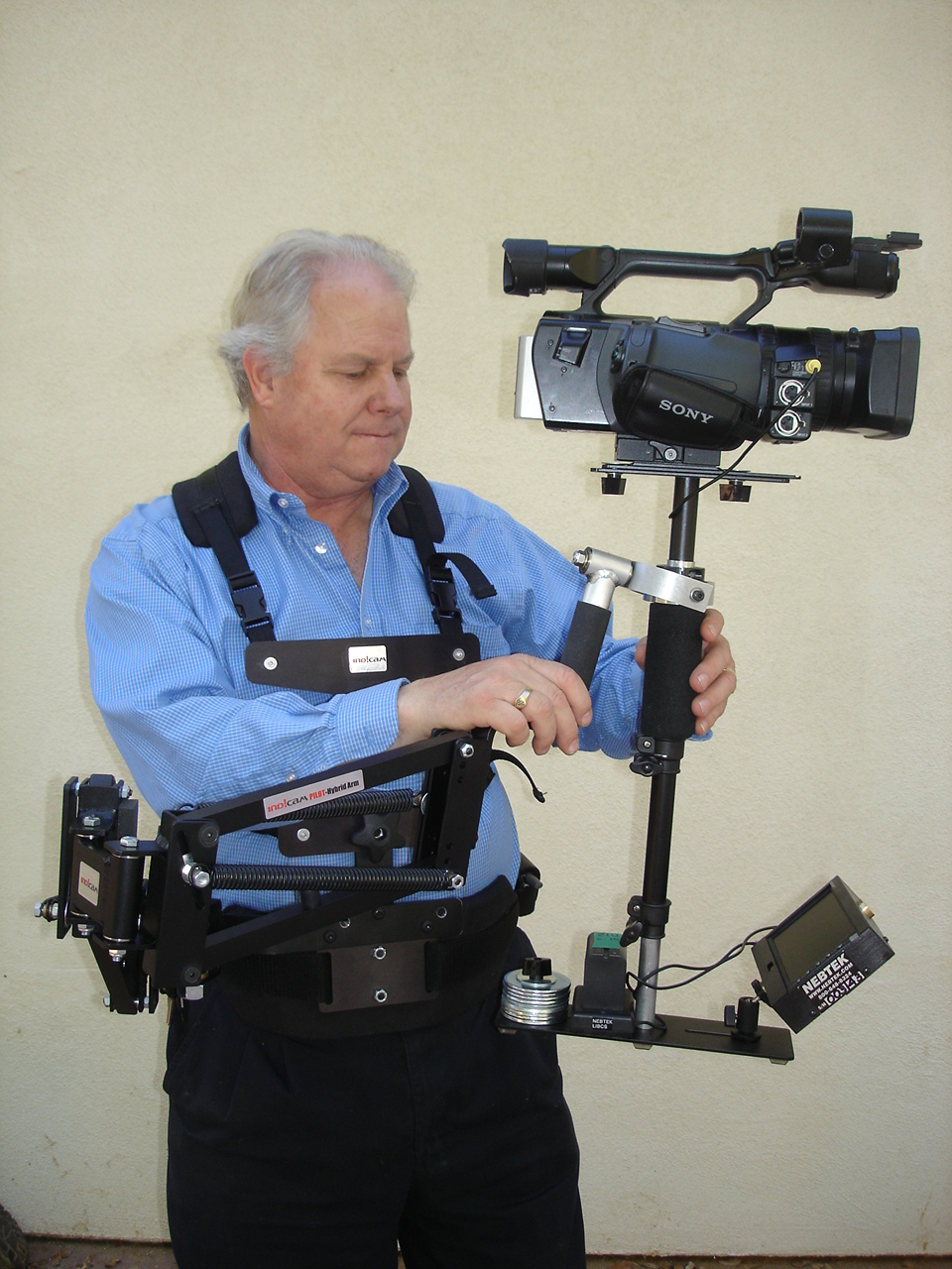

Here is a picture of our rig that we altered to have a bottom mounted monitor. It is similar to what you would have to do with your Glidecam only you would adjust one side of your bottom plate to hold the battery and whatever weight washers you needed to balance the rig.
We did drill small holes in the top of the post and the bottom of the extension post to accommodate the video cable. You would route your power cable there instead making sure it wouldn't snag or short out. Make sure you include enough extra length to allow the bottom extension post room to extend. When routed inside the post it doesn't affect your balance like going on the outside of the post will.
