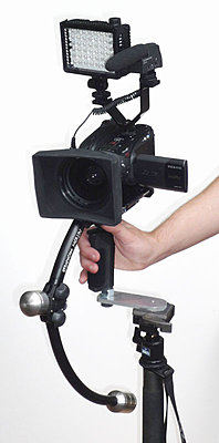

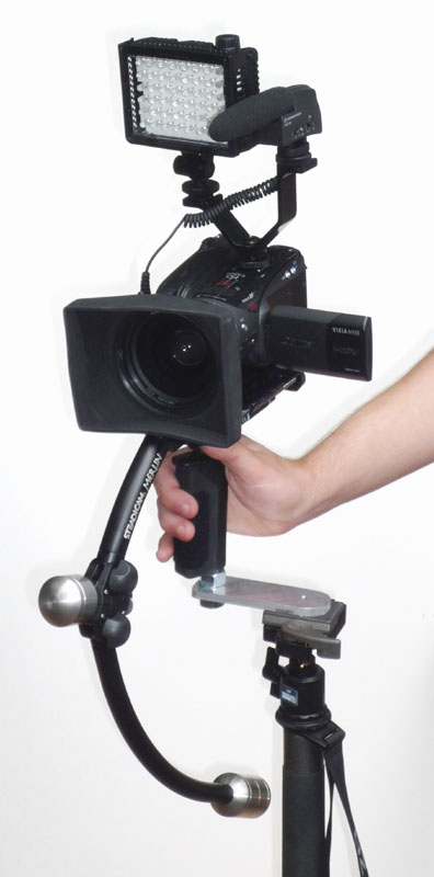

I'm new to the Merlin world, but I built a small adapter that I've been able to mount onto my monopod.
I haven't had a chance to use it yet, but it's a simple way to connect the Merlin to the monopod via a quick release, with enough offset so the Merlin doesn't bang into the monopod.
I'll try to make some photos of the rig later today and post them here.

As promised, here's a page that shows some photos of the offset arm I made for using the Merlin on a monopod or tripod. The page shows the parts and fabrication details.
http://www.zenreich.com/ZenWeb/video/merlin_mount.htm
