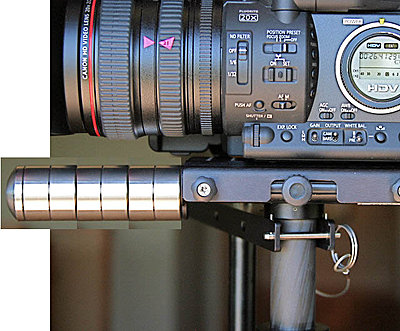

I would be extremely interested to know your opinion on how the Pilot operates with lots of additional screw on weights, and how that compares to your big rig.
When I took the class with Tom, they had a Pilot set up with no additional screw on weights, and it felt like a toy. The additional screw-on weights really make a huge difference, especially at the bottom.
Specifically, with the XH-A1 weighing in at 5 pounds (including it's battery), I would add:
- 2 middle weights plus 1 end weight to each end of the bottom crossbar
- 6 middle weights plus 1 end weight to each end of the stage
The total weight for this would be about 9.5 pounds, and the gimbal would be 2-3" away from the stage.
I did a quick photoshop of your picture from the review to see what this would look like (I hope you don't mind). The picture shows the 6 middle weights and 1 end weight on the front of the stage. It looks like this would fit under the lens hood and not get in the way.
This would require a total of 16 middle weights. Since the Pilot only comes with 4 middle weights, you would have to order 12 more. You can order additional screw-on middle weights directly from Tiffen - Part # 801-7920-05, $6.25 each.
I really think Tiffen should include a lot more middle weights with the Pilot. After experiencing the added control with more screw-on weights, I think every Pilot owner will want this. 12 weights would cost $75, which is pretty cheap in the scheme of things. The real issue is the hassle of ordering from Tiffen, and the wait time for the order to ship (I had to wait a month). It would be much better if Tiffen just included these weights so new Pilot users could feel this added control right away.
Anyway, Charles - if you ever get a chance to use a Pilot that's fully loaded up to around 10 pounds, with some of that weight at the ends of the lower crossbar, please let us know what you think.
