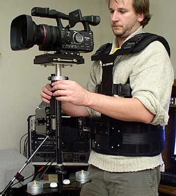

FWIW the Glidecam 4000/smoothshooter combo is not meant to be used at the 'sides' of the body, but rather directly in front of the operator. The points regarding left or right hand operation still apply but the camera should be in front of the operator. This is different from most Steadicam rigs from my understanding.
In particular you will notice that if you have a larger load on the 4000 sled and are NOT using the X-10 dual arm with the Smooth Shooter there will be some twisting of the non-sprung arm, which becomes more pronounced if the camera is operated from the sides. As well unless you have the X-10 which includes a vest/arm adjustment you will notice that the sled does not like to stay out at the sides with the operator in a proper upright position. It tends to either fly away from or twoards the body and puts a lot more stress on the operator.
