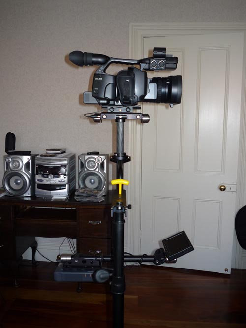

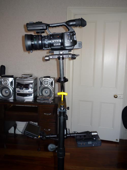

I i think i have just come across the exact same problem as Julian had with his Pilot while trying to dynamically balance mine with my new EX1... never had the problem with my HVX however.. which is strange..
I can statically balance my rig 1 way.. and then spin it 180 degrees and the nose tilts forward.. the horizon does stay horizontal however..
I cant think of any other things that might be causing this..
Running 2 middle weights and 2 end weights on the stage.. same as my HVX setup - the cameras weigh about the same. 4 middle weights and 2 end weights on the cross bar.. 3 second drop time. Monitor and battery extended all the way out dynamically balancing (well trying) just by moving the cross bar and the top stage.
When i spin the rig the nose tilts forward and the battery goes arse up. Which is the exact same thing that happens when i spin the rig 180.
Im going to keep playing but if i cant get anything by the end of the day i'm going to have to give tiffen and my dealer an email.
What really sucks is i have a New Years eve shoot and was meant to be flying.. and it has to be an EX as we're shooting everything with them.
Right now being so isolated in NZ really sucks.
edit - photos attached. Not as bad as Julians.. but still present.
If it can go wrong, it will go wrong!!  Pilot Error!-balanced.jpg   If it can go wrong, it will go wrong!!  Pilot Error!-unbalanced.jpg

That looks like a gimbal linearity issue, Joe. Definitely contact your dealer and/or Tiffen (your dealer will likely have no clue what you are talking about).
There's no reason why you can't continue to work with the rig though. Under most circumstances you won't have to pan more than 45 degrees from straight ahead, you just rotate your body to keep within that range. Going into Don Juan and back to Missionary during a shot is relatively rare, that's when this might bite you a little but it's entirely possible to overcome this with a little more influence. Certainly the problem should be fixed but I wouldn't call this an operating dealbreaker.

Charles, your right, as long as i know the issue is there im sure it wont be to much of a hinderance, Its certainly not as bad as Julians issue, at least its only slightly out.
I've contacted both my Dealer and Tiffen, and have already had a response from my dealer saying they will try their best to get it fixed asap. Early next year will be fine. The new years shoot isnt that crucial steadicam wise.
I will keep everyone updated.

Hi Joe,
I hooked up with a practice partner in my area, and he had the same problem with his EX3/Pilot. He shipped it back to Steadicam back in L.A., and they said the problem was with the 2 little screws on either side of the gimbal handle. Apparently, Steadicam forgot to put lock-tight on those 2 little screws on his Pilot when it was built, so they came a little loose, and the bearings in the gimbal handle weren't working quite right.
You may be having a different problem, but it's worth checking. The screws almost look like rivets, but they have a small hex wrench hole in the middle. I checked my screws and they're tight, so I guess this is happening on only some Pilot units.
Hope this helps.
