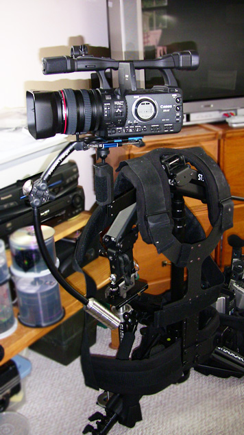

I have a wide angle lens on this one but its set up as you mentioned. I've got the screw in front supporting the lens between the focus and zoom rings also. It took a while to get it set up so there was no pendulum effect when I stopped. I'm coming from 6 years on a Glidecam and it seems like the merlin is much more sensitive to any adjustments. I find myself having to tweak the trim all the time.
http://www.dvinfo.net/conf/images/attach/jpg.gif
