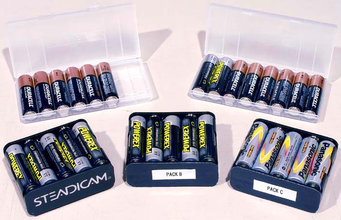

at $25 for a pack of 8. I got 4 packs for a total of 32 AAs. Since the Pilot-AA uses 10 batteries, this is enough for an online set plus 2 spares. Since each set lasts around 4 hours, this is enough for 12 hours of shooting. This means I never have to break out my battery charger on location. I also carry 10 AA alkaline non-rechargeable batteries for emergency backup.
The same place sells a nice 1-hour fast charger for 8 AA batteries:
- MAHA MH-C801D AA - AAA Battery ChargerDELUXE 8 Cell Profes..
for $69 each. The LCD readout shows battery charging status for each of the 8 slots. You'll need 2 of these to handle the Pilot's 10 AA batteries. The 6 extra AA charging slots are also nice for my other stuff (Fostex FR-2LE sound recorder and Sennheiser G2-100 wireless lavaliere mic).

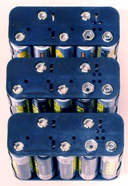

I also highly recommend buying extra battery holders for the Pilot-AA. You can buy 2 of these on eBay:
10 AA Battery Holder-New- Quaility Replacement! - eBay (item 120307048297 end time Oct-17-08 18:10:04 PDT)
for $14 shipped. This way you don't have to deal with switching AA batteries on location. You just swap packs of 10. See attached pictures.

I used to have different brand batteries, like you see in my pictures above, but then I noticed that some AA batteries weigh more, and some weigh less. This throws off the Steadicam balance when you swap between the different types. Obviously, I can re-balance the sled to compensate for different weight batteries, but it takes a little time. It's much more convenient to buy all batteries of the same exact brand and type, this way I don't have to re-balance when I swap batteries. So I bought 8 more batteries and they are all the same now. If you like the batteries you have, I suggest buying more of the exact same type.
As for how long they last, a fully charged set of 2700 mAh NiMH batteries will usually last around 4 hours powering just the monitor. Less in cold weather. Also, if you power camera stuff off the 2.1mm power connector on the front of the stage (e.g. video transmitter, LED light, etc.), the batteries will obviously run out sooner.
