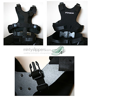

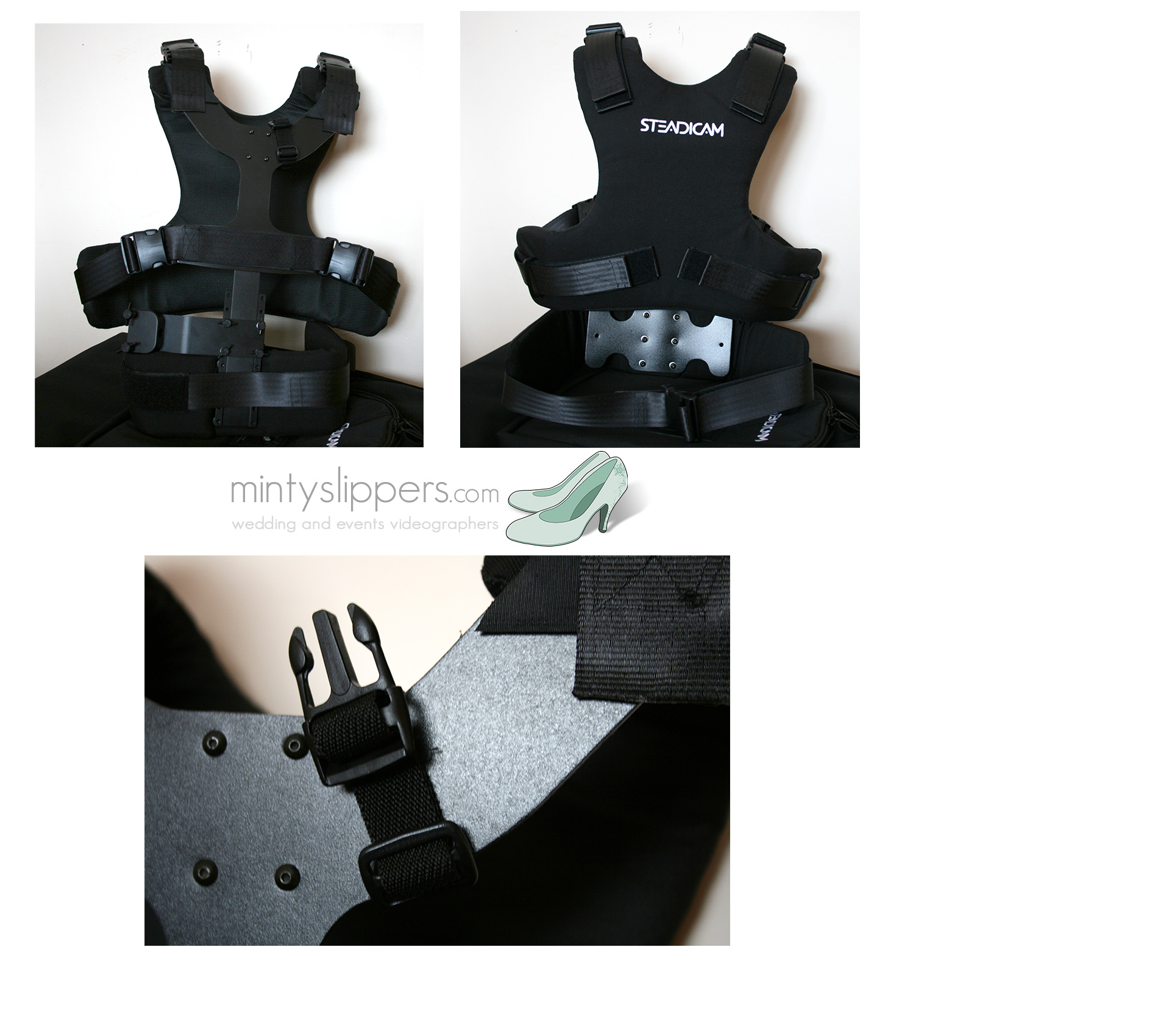

Location: Northampton, UK
Posts: 915
I have now modified my vest to completely use quick release buckles and all mounted to nylon webbing for smooth changes to the size and added strength.
I mostly went with Franks design although added nylon webbing to the shoulder supports too. Also I opted to double back the webbing and use velcro to secure it which is much more like the flyers vest.
Also on the arm is a stitched piece of webbing for the arm stay.
Modified the Steadicam Pilot vest from velcro straps to buckles-steadicam-pilot-vest-quick-release-buckles-nylon-webbing.jpg
