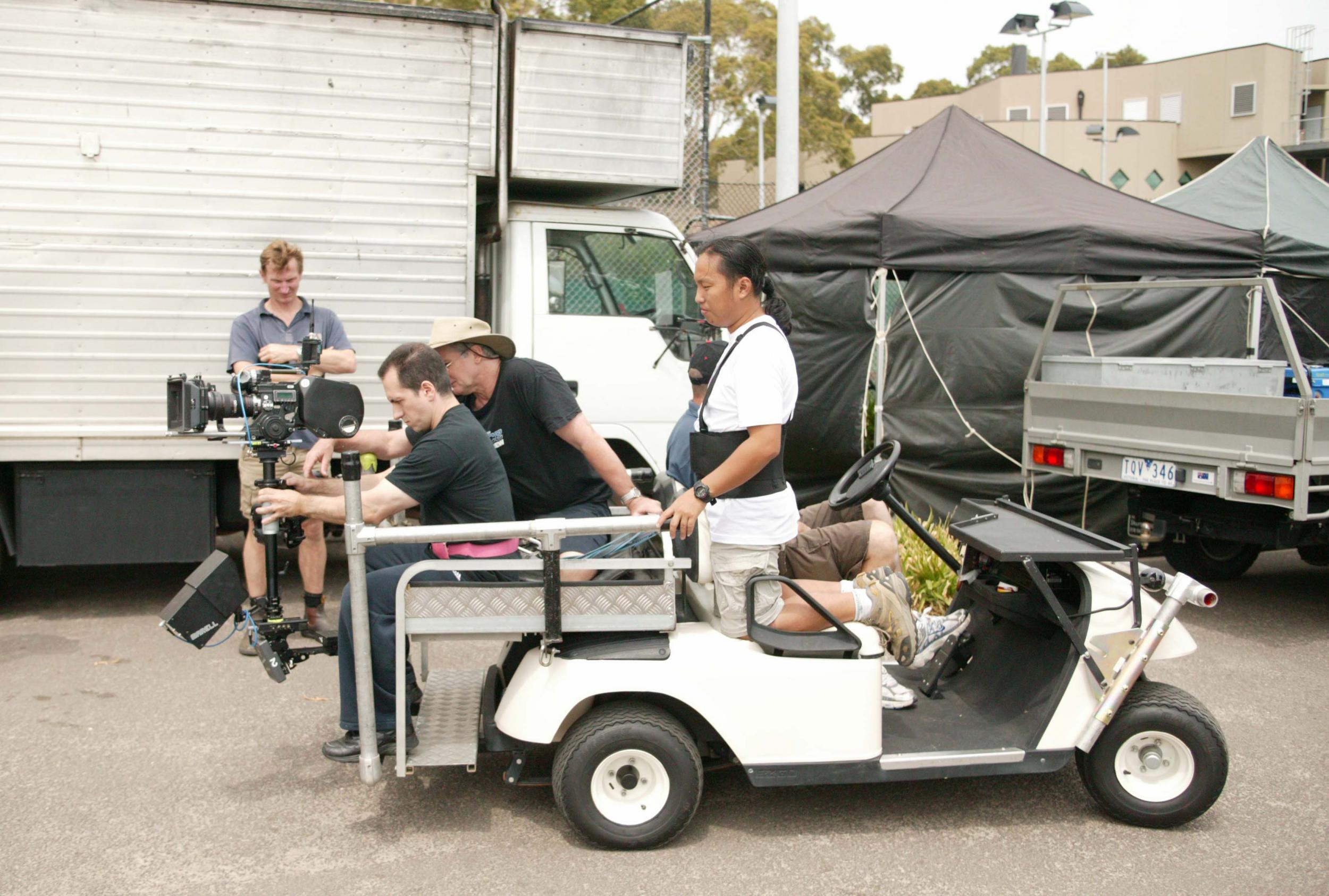

can anyone share any pictures on such setups?

Hardmounted and using a a safety harness.

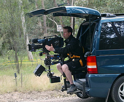

i have a steadicam flyer, new to it and currently mount video dslrs on it. will move up to red ff35 once it comes out.
i'm looking to build a light car mount, something on an easier side.
i'm thinking of getting something like this:
Walter Klassen FX -- Vehicle Mount
and somehow securing a mount or a pipe in an suv or a pickup to hold to that clamp or head mount.
anyone went through the same and can suggest an easy solution without building too much of a "special car" :) ?
something like the attached image i found, but for a lighter setup (no operator seat as complex as this, etc...)?
