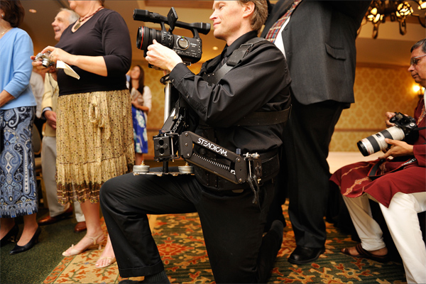

so the only person here with the experience of flying GC on Merlin arm and vest is Joel. (joel! we're counting on you! hahaha) how're those pictures of your setup coming??
Attached is a shot that shows the GC 2000 with the Merlin arm. When I add the wide angle lens I just need to slide the camera platform back to a spot I've got marked. Though the post I hacked together isn't visible I describe it here:
http://www.dvinfo.net/conf/stabilize...erlin-arm.html
I know of a videographer that is working on machining a straight post that is more solid. There is a chance that copies of that might be available to buy.
http://www.dvinfo.net/conf/attachmen...1&d=1243523971
