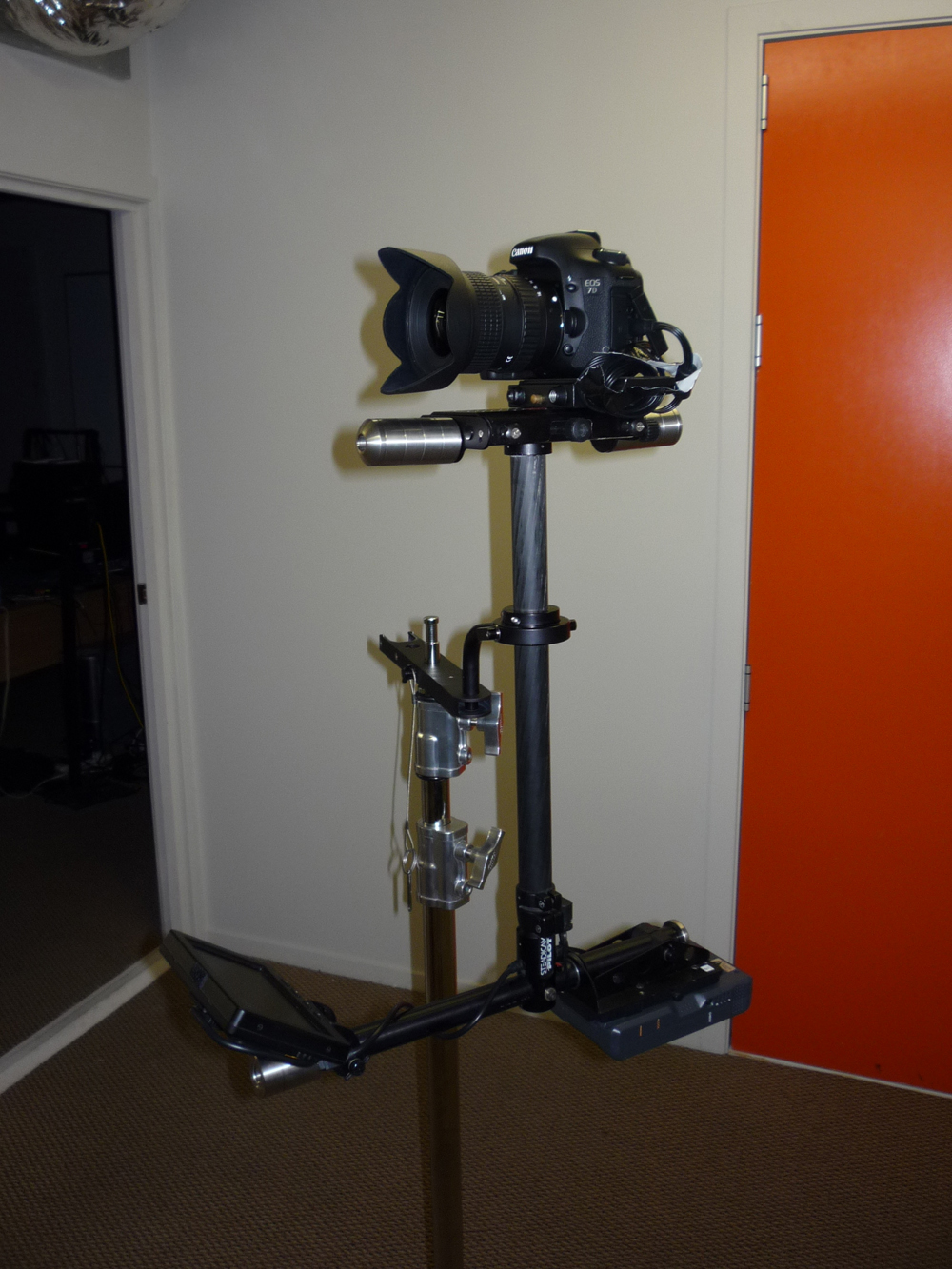

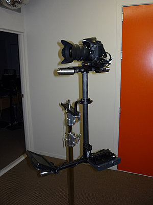

Flying a 7D tomorrow on the pilot. Rigged the sled up today..
Even with a bunch of pilot weights on the top stage.. i could only just get a 2 second drop time, and even then the gimbal is to far down the center post for my liking..
Managed to get nice DB however.
Tokina 11-16mm stopped down to about F8. No budget for a wireless follow focus on the job let alone room.
Although with a Zacuto mini baseplate and rails i could probably do it, would also help with the weight of the whole thing.

Old March 8th, 2010, 03:51 PM   #7
Location: Northampton, UK
Posts: 915
True, the pilot weights are amazing. Problem being to get the same weight would mean having some crazy long top weights and these things cost £20 per little weight!

Old March 8th, 2010, 03:54 PM   #8
Join Date: Jul 2004
Posts: 418
Yes, its a shame the price's went up.. I bought a bunch of extra ones for my rig when they were at the old price - $5.95USD or so each...
