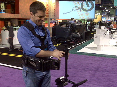

Grrr... I was happy with my Steadicam Pilot... then I went to C.E.S. (the Consumer Electronics Show) in Las Vegas this past week, and met up with Michael Craigs, Robert Orf and Dan at the Tiffen - Steadicam booth.
Dan let me try out the Flyer LE... it was smooth, easy to operate, and just seemed to fit me! I couldn't stop grinning! Now I have to save up for the damned thing!!
I hate you Tiffen - Steadicam!!
Just kidding.
Julian
(Blackberry photo attached, excuse the quality)

The Flyer LE has a better vest, the arm seems to isolate the sled's movement more, and you can support a heavier camera. Operating the Flyer LE seemed really easy, compared to the Pilot... probably due to the greater inertia of the unit. The wider, knurled grip on the post also helps control the sled a lot more. While I'm certain I made numerous mistakes while operating the Flyer LE at the show, I think I got better results with it, more easily, compared to the Pilot. I took to it like a duck to water, and didn't want to give it back!
Julian
