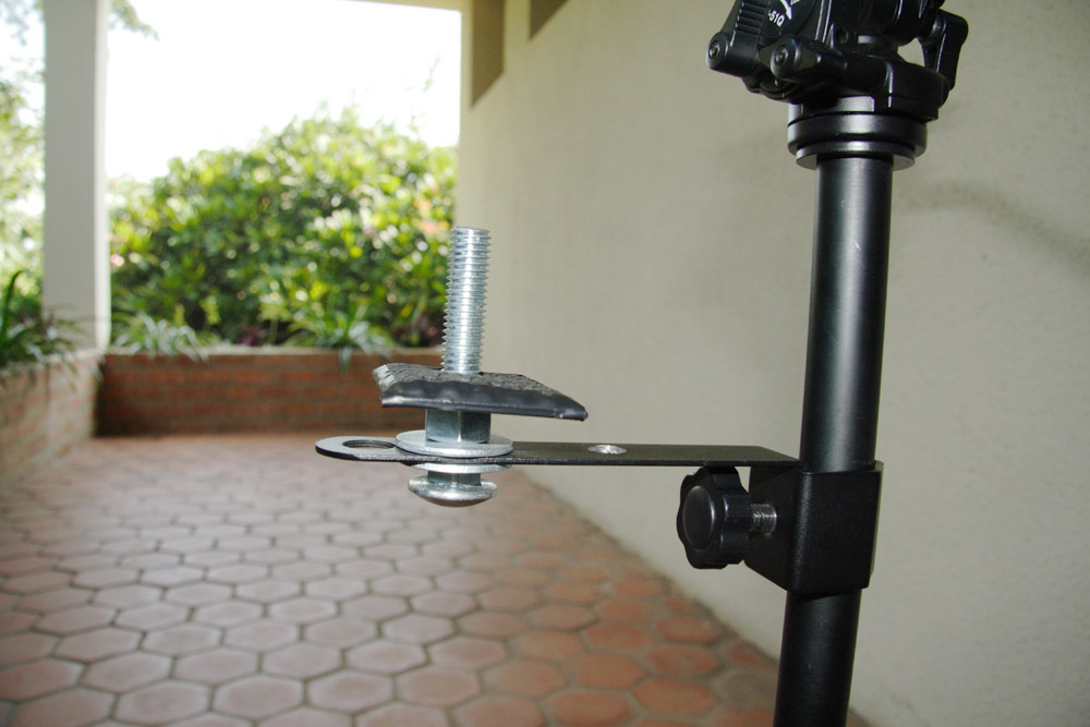

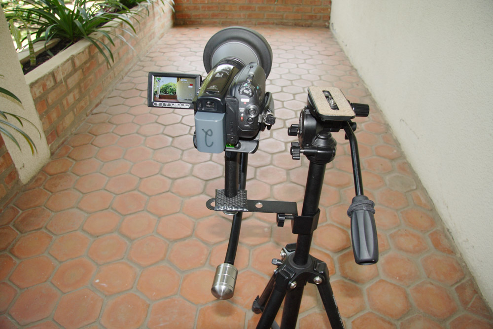

this is built using an Apex mic stand microphone mount (about $10). i drilled a hole for a bolt that fit nicely in the Merlin handle and threaded a piece of flat metal for support (with kitchen drawer grip material taped on for padding and so the handle would not rotate). the nuts/washers lock on the bolt and also can adjust the right length for the bolt to fit in the Merlin handle.
