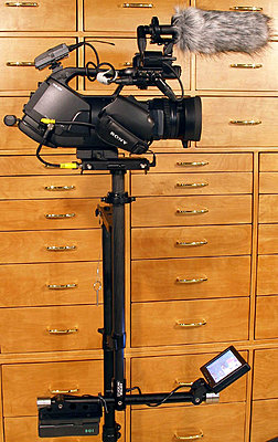

First, realize that you've just bought a beautiful camera. If you want professional footage on a stabilizer, you'll need a good stedicam and months on practice.
Having said that, if you remove eyepiece and battery, the EX3 only weighs around 6.5 pounds. Add some accessories, and that's perfect for the Steadicam Pilot (see attached picture).
As for the cheaper stabilizers without a vest and arm, I wouldn't bother. The EX3 is heavy. Your arm will get tired really fast. Besaides, the vest, arm, and monitor make a lot more things possible.
Think of it this way: In 5 years when the EX3 is outdated, your sticks, jib, and steadicam will still work great.

I have the EX1r and i am trying to mount the mic as yours.
Can you post a closer photo of your mic mount?

Originally Posted by Giannis Pass View Post
Hello Dave Gish.
Here's 2 close-ups.
http://www.dvinfo.net/forum/attachme...x1-3-ex3_2.jpg
http://www.dvinfo.net/forum/attachme...x1-3-ex3_3.jpg
It a Rode SM3 shockmount that goes on the camera shoe. Got it as part of a kit:
http://www.bhphotovideo.com/c/product/400812-REG/Rode__NTG_1_Condenser_Shotgun_Microphone.html
RØDE Microphones - SM3
Dave Gish is offline   Reply With Quote
