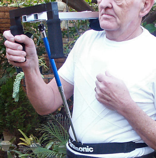

For over $700 I would cringe!!! It's basically a harness with a pouch and a monopod!! Without any sort of gimbal you will get stability but not freedom of movement.
The closest I have seen with a monopod system so far is the "SteddiePod" ($499 at B&H) This has a bearing collar and grip on the first section of the monopod tube so you can at least have a 2 way gimbal and actually fly your camera. There are quite a few YouTube videos on the rig too showing it in all it's modes. The EX1 is fairly heavy so the fact that you fly by holding the monopod directly under the camera's centre of balance will make life a little easier!!!
If you are not prepared to pay the $4000+++ for at least a Steadicam Flyer then this is probably better than Sony monopod.
I use a DIY support on my cams which cost me less than $40 and it essentially does the same job as the Sony one (without the "crane" feature) The support is a tripod leg so you could also use a monopod.
Chris

Nice to hear from you also!! Actually the guy that designed the "SteddiePod" was Eddie Barber and he started off modifying monopods for ENG cameramen in his earlier days.
Even if you just want a support then his idea also has merit with the 3 foldable legs on what is basically a monopod!! If you look at his site, in support mode, two of the legs are used against your body to take the camera weight and all you have is a simple strap around your neck for full support.
I really cannot see any advantage in having a complete "vest" like the Sony one just to hold a monopod!!
It's actually a lot more expensive than the generic stedicam vests you can buy at the moment so if a vest is a must, CineCity in India would probably part with one from their flycam range for around $300 and you can buy a nice monopod for less than $100 too!!!
Disregarding the pic in my post, I have a Benro hefty monopod (25kg capacity) and have attached a moveable disk on the upper shaft which allows you to hold it in one hand at a balance point and works pretty well considering there is no gimbal.
Thanks for the link...nice stuff!!!!
Chris
