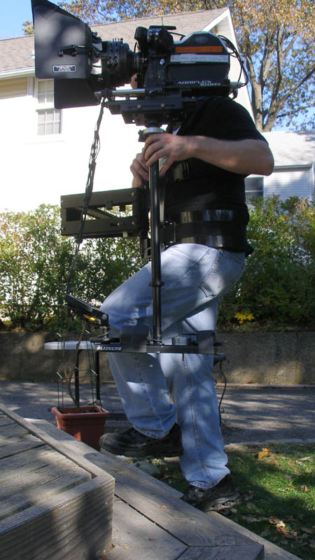

Old August 31st, 2010, 06:39 PM   #2
Join Date: Jan 2003

Here in Australia a Flyer LE will set me back $10K !!!!
There are many cases where people assume they need a Flyer when a Pilot will do. Here's an example(see picture).
There are a lot of ways to reduce weight. The camera can be powered by the sled. Unnecessary parts of the camera can be removed (in this case, the EX3 EVF hood). Custom cables with light connectors. You can lose the rails by using a clip-on matte box, or even a simple custom matte box made from black coroplast and gaff tape. Some of these require a little DIY ability, but it's relatively minor compared to modifying the rig itself.
Obviously, there are cases where a Flyer is mandatory, but I tend to find they are fewer than most people realize.

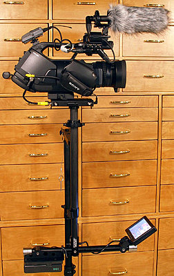

Old September 8th, 2010, 09:58 AM   #15
Join Date: Feb 2008
Location: Riverdale, NJ
Posts: 468
I guess if you can afford an EX3 then a pilot is also within budget.
To be clear, that's not my camera, just one of many I've worked with.
I've used the Pilot with the Sony EX1, EX3, Z1U, V1U, and the Panasonic HVX200 on various gigs. I've also flown an old Arri SR3 film camera with a rented Glidecam V20 (see picture).
My camera is an HVX200 I got cheap on eBay.
In general, I think cameras have gotten really good, so you can get good results from most of them. Now it's getting to the point where other things seem to matter more than the camera, like good content, lighting, and how smooth the camera moves, whether on sticks, dolly, jib, or steadicam.
