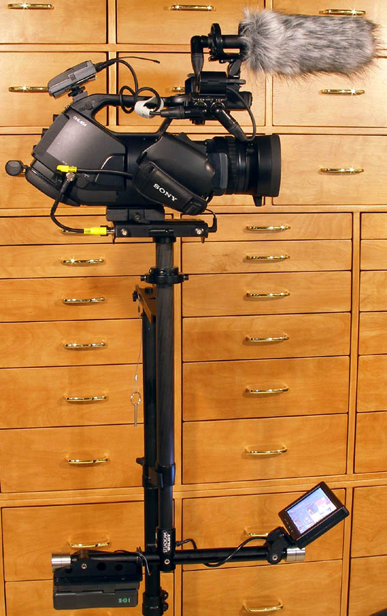

I've flown an EX3 on my Pilot with a shotgun, wireless mic, and wireless video, and the arm was level.
http://www.dvinfo.net/forum/attachme...ion-ex3_1t.jpg
Do you power the EX3 from the sled? Do you remove the EVF hood? What accessories are you using?
