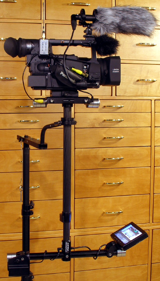

I have some tricks that help speed my setup. If I reproduce the positions of the components on the sled very closely each time, then balancing is really quick, more of a balance check or small tweak. Toward this end:
1) I always extend the center post the same amount by measuring the width of 4 fingers.
2) I always slide the battery back as far as it can go on the lower spar.
3) The monitor is permanently positioned very far forward, so that when it touches
the screw-on weight it's at the correct viewing angle. So I just pivot the monitor down until it stops.
4) The tripod adapter and plate are the exact same length, so I can reproduce the fore/aft position of the camera by simply feeling how the plate lines up in the adapter before I tighten it down.
Here's a picture to help show what I'm talking about.
Obviously, if I'm using different camera accessories than usual, or doing something special, like low-mode, then I'll need more time to setup and balance. But for the normal setup and accessories, it's closer to 5 minutes.
Dave Gish is offline   Reply With Quote
