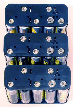

1) Top heavy can be a good thing. With the pilot, you want about 8 pounds of top weight (camera, accessories, and screw-on weights), and about 2 pounds of bottom weight (battery plus screw-on weights). This seems to yeild the best stability for me. The XHA1 only weighs around 5 pounds, so you want extra top weight with that.
2) If you are powering the camera (e.g. EX1, EX3) from the Pilot's battery, choose the IDX. NiMH AA batteries have a slightly different voltage, so the camera thinks the battery is low when it's not.
3) You can power other accessories besides the monitor with AA batteries. For example, a freshly charged set of NiMH AA batteries will power the monitor alone for around 4 hours. If I add a small video transmitter, the NiMH AA battery pack lasts around 2.75 hours.

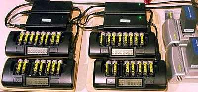

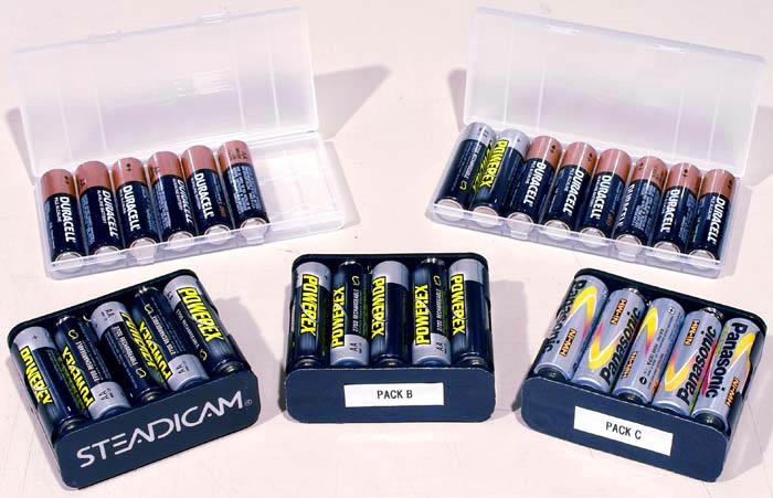

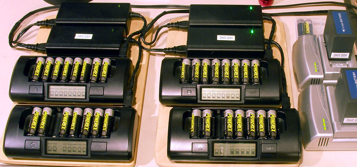

4) Contrary to popular belief, AA batteries can be very convenient. I bought 2 extra battery holders, 30 rechargable AA batteries, and four 8-slot AA fast chargers. With this configuration, I can charge enough batteries to shoot all day in only 1 hour. I also stuff the batteries into the holders at home, so I don't have to fool with AAs on location. And if for some reason all 3 packs run out, I can just use regular non-rechargable AA batteries as back-up. This means I usually don't have to charge batteries on location at all. The combination of charging all 3 packs at home in 1 hour, plus not having to break out a charger on location, that makes it very convenient for me.
