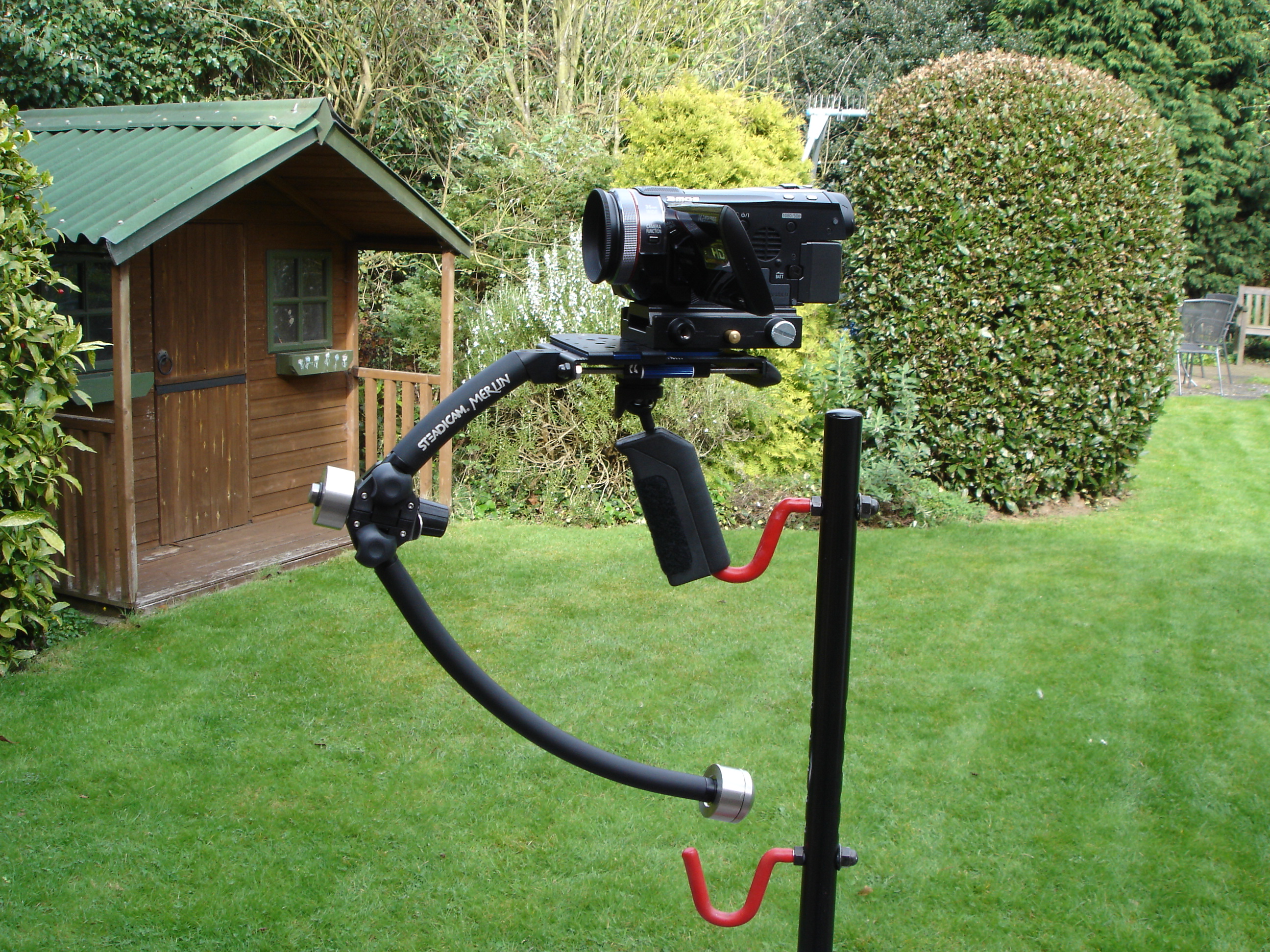

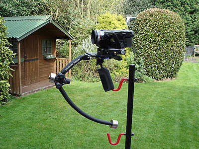

You could always use an old bike stand - like I did here in this pic of the TM900 with Steadicam Merlin - far cheaper!
Actually this was just a temp solution - I'm looking for something much better and more stable/secure - Bet I can find something that'll be ideal for a lot less cost than the official stand! ;-)

Nice Idea Andy but my MTB is always on mine!
I'm going to get a tripod mic extension and adapt it - only £9!
Pete
