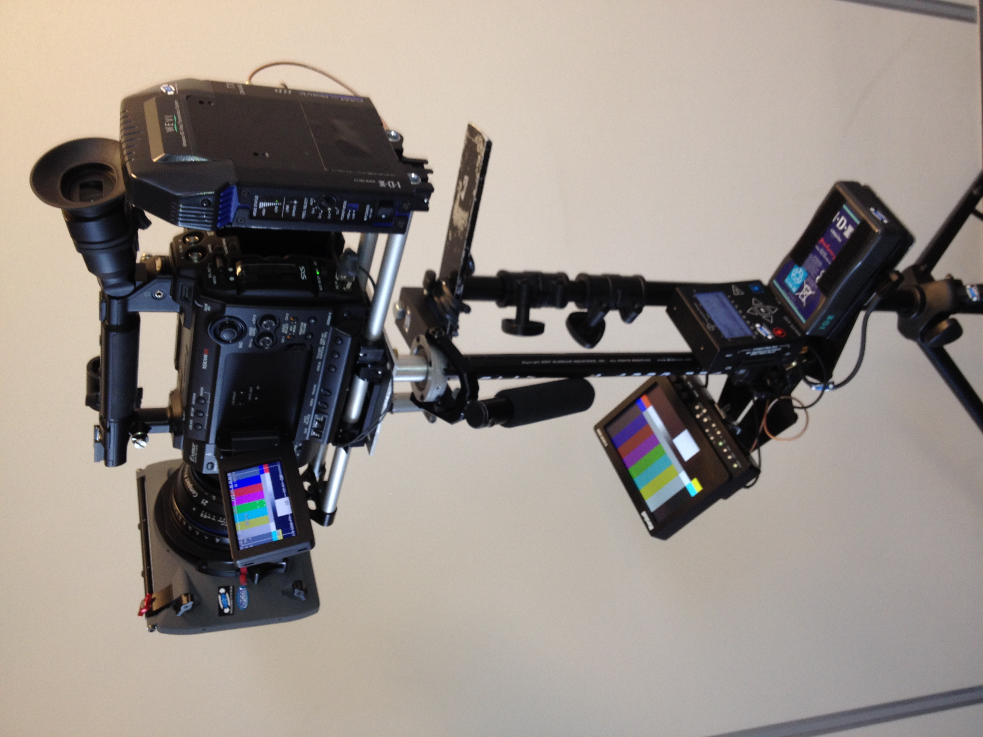

I have a glidecamsetup as 'toy rig' for light camera's and a managed to have up to a Sony F3 (stripped) + camwave on top and a Vlock battery plus Marshall HD monitor and CDrecorder at the base
I must say it's not easy to get dynamic balance, but i needed a small and light rig for a shot.
It took some 'mcgyvering' but hence, anything to get the shot done.
With an EX1 (2,5kg) it is easy to do, but you need a battery or so on the other end of the base.
I even had it perfectly dynamic and static balanced.
I have the glidecam rig for sale actually, as it is collecting dust here.
I made holes for cabling running through the pole but there's no roon to run a HDMI cable, or you must remove the connector and put it back on.
I have HDSDI and power cabling on the rig
