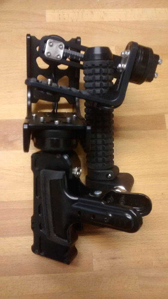

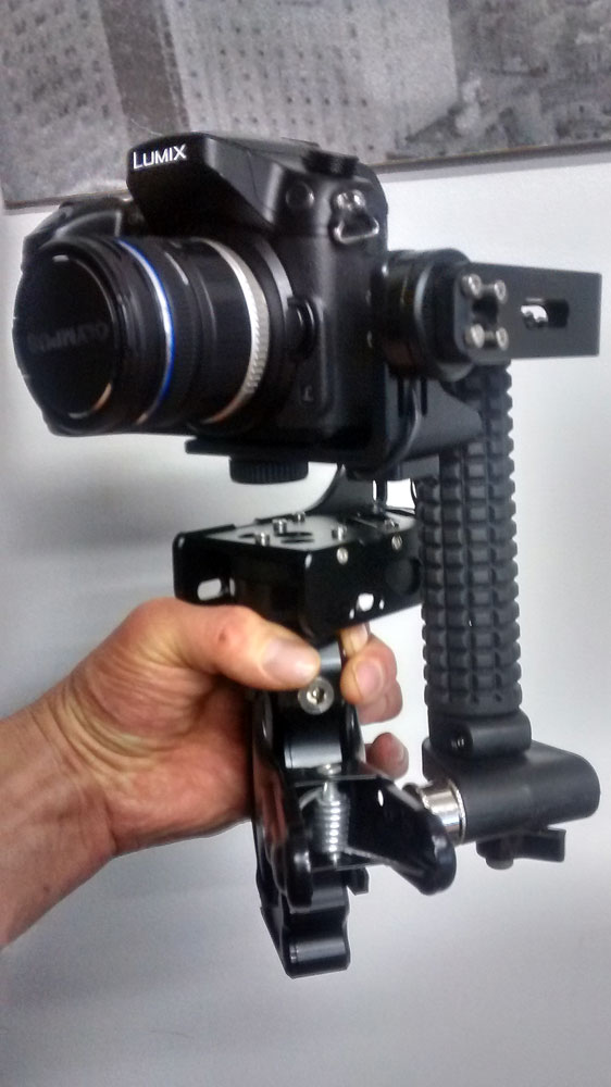

I found a simple solution that prevents the handle and the part that supports the camera from turning the wrong way, it's far from ideal and looks a bit silly but it does the trick. I attached a clamp to the handle and attached a handle that came from a dslr rig onto the clamp and that handle extends into the arms that hold the camera, that handle and clamp has a soft rubber grip so it doesn't scratch any parts from the Nebula.
When I stop using it I can attach the clamp onto the handle, remove the camera and store the Nebula, next time I will be using it I can be 100% sure I won't turn the handle in the wrong direction, same goes for the support plate. I can also use it while the camera is on the support plate when I move between locations, just clip the clamp onto the handle before I put it into a bag and this while the camera is still attached, this again will prevent me turning the handle into the wrong direction when I use it again. The plate holding the camera is not an issue for me when the camera is attached because it will prevent it to turn all the way round.
After looking more into these parts and how they accidentally can turn into the wrong direction I find the handle equal sensitive to problems, eventhough you can see the wiring but you can't see how much they have twisted inside.
It should be fairly easy for the supplier to custom make something that attaches to the handle and camerasupport plate and fixes both from moving using the Nebula's frame to keep them in a fixed position while you are storing or transporting the unit. If they are that worried about the cable breaking that should be their first priority to produce because it applied right, there should not be any risk of a cable that breaks off and if there is, then there is no discussion it's caused by the user. Or, even easier if they decide to make a V2 unit to include hard stop like on the Feiyu g4 so it can't make more then one cycle.
What do you guys think, a stupid idea? :)
