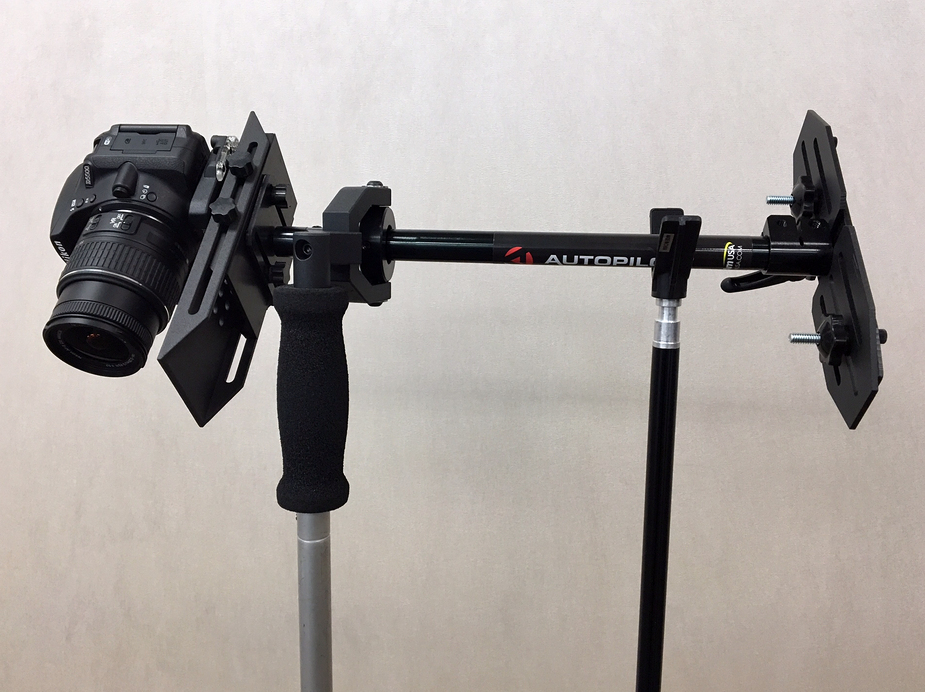

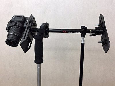

Recently I have been using two stands to assist in balancing my stabilizers using the methods shown in the videos.
One stand fits into the 5/8-inch opening in the grip.
The second stand has a V-Groove attachment with a 1/4-20 threaded base.
Using the first stand, with the stabilizer hanging vertically as it normally would, I work on the static vertical balance.
Then I swing up the base of the stabilizer so the center column is horizontal and lay it in the V-Groove of the second stand.
Now I can adjust the entire rig to be balanced around the center column by rotating the stabilizer while it is horizontal.
Then it's easy to lift the column out of the V-Groove and keep adjusting vertically until it's satisfactory.
Continue the process, including actively moving the rig around, then return it to the stands and keep making smaller and smaller adjustments until it's balanced.
Using two stands allows much easier adjustment, taking most of the load and variability out of the equation versus hand-holding.
In this photo, the stabilizer really is horizontal. The two stands exit the bottom of the image.
By using just a fingertip to slowly spin the base of the stabilizer, you can tell where to adjust the balance around the center column. Essentially I'm working in the horizontal to equalize around the center column that's normally vertical when actually shooting. When balanced, the rig won't roll on its own no matter what position it is left in.
HELP: Unsteady video w/ handheld stabilizer-stabilizer-horizontal-balancing-925h-img_0702.jpg
