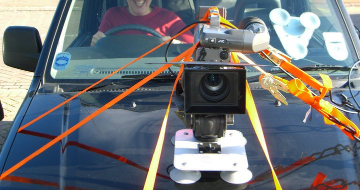

I used a sticky pod on a big heavy camera - I modified the aluminium plate to take an old manfrotto 501 head and then mounted the camera on that. The straps are simply to stop the camera falling sideways and to act as security - the straps were not tight, and the rubber mounts worked surprisingly well. Worked pretty well on the small 4x4 that has little in the way of soft suspension.
