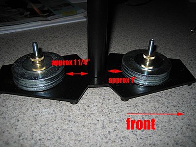

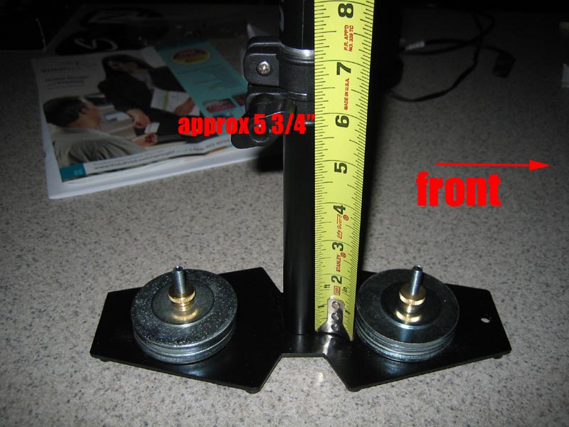

OK, I've attached 2 pictures. What I'm referring to as the front is the bottom of the glidecam that has the monitor hole in it, also where the camera lens would be faced.
The measurements are approximate, but they give you a good idea where to start. I'm still playing around with it, but this setup gives excellent results. It has a drop time of about 1.5 sec.
There are 4 weight plates on each side. It could probably use a little more weight, bit I've achieved great results with 4 + 4 weights

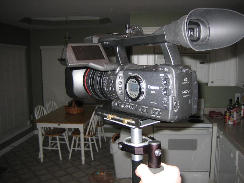

The pics are much appreciated! (can we see your camera on the top of the rig?)
I'm finding I'm closer to full balance with five cw's... I tried your exact setup... but need to see how you've balanced the camera and what you have on it. Possibility, my man?

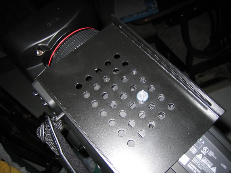

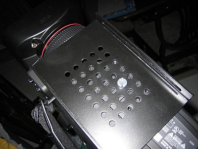

Camera is balanced with the 950G battery that came with it, no tape, lcd open, clear glass and polarizer filter on it. It's pretty quick and easy to balance. I set it up in less than 2 minutes. I've also tried with 5 weights (10 total) and its a little different, but it just feels unbalanced to me with 10 instead of 8. I also added a picture of the bottom plate so you can get an idea where I mounted it.
