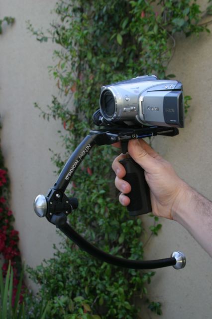

HV20 and Merlin
Put 'er up today for a spin (literally/figuratively)...took less than 10 minutes to balance from scratch. Talk about a featherweight! Truly amazing to be shooting stabilized HD with such little effort, you could carry this setup around for a good long while I suspect. For serious work you would want to add some weight (wide angle lens would be a good start).

really interesting!
I currently have the HV10 and the Glidecam 2000 pro but really struggled to get it to balance as the HV10 is just so light. Is the HV20 heavier than the HV10? With the HV10it would just about balance if no weights are used at all on the bottom.
I have a merlin also and I love it. I just bought the HV20 to replace my dying HC1. Can you tell me what the adjustments are on your setup since Merlin cookbook does not have the HV20 yet. Thanks.

OK, I will admit that I'm not a "cookbook" guy--normally I'm not adverse to reading directions but my 8 zillion years as a Steadicam operator make me a little too proud to think I can't soldier my way through this sort of thing. Although some of the more obscure bits that are unique to the Merlin left me a bit baffled at first (G-platz??!) but I quickly got the hang of those.
So, having now consulted the online cookbook to understand what to call the settings, here goes:
Front weight: 1 finish
Lower weight: 1 start, 1 finish
Arc size: 9 1/4"
Mounting hole: J
Stage mark: n/a (already took the camera off...somewhere in the middle)
Z: -2
G-platz: no
This is for stock HV20 with tape, standard battery and no accessories.

Thanks, Charles! It actually helped me out a lot with your configuration. I probably saved easily 1 hour's worth of fiddling around. Your "cookbook" worked perfect! What else should I expect from a professional Steadicam operator, huh? Well, I hope your friend decide to market that new accessory! Again, thanks, Charles!

There are some HV20 settings in the "user" section of the cookbook area:
http://www.merlincookbook.com/user.php
I ordered a Merlin a few days ago... should be delivered tomorrow. Can't wait to try it out.

Looks like we had identical settings...except 1.5" different in the arc, which seems inexplicable! Maybe I didn't measure it correctly.
Incidentally, I sent a pic of the camera atop Merlin to Garrett, who was surprised at the weights and arc for this weight of camera, so a bigger arc seems even less likely...
