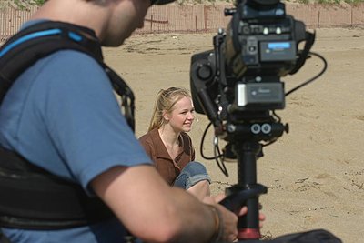

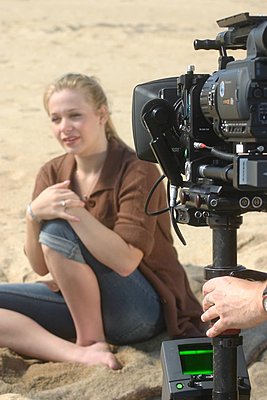

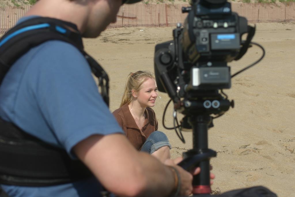

Hey Jaron,
Good points on everything. The issue of the monitor/operating side needs a little clarification, however. The monitor on rigs that have one is mounted where it is to help distribute the weight of the system. Also, by placing it in the center relative to the post, it is not obstructed by anything - making it viewable regardless of which side the operator is on. Any operator, whether regular or goofy, frequently switches sides of the camera depending on the shot. The side the arm is mounted to the vest does not change, but the side the operator is on can change many times during the same shot (see attached pictures). With a monitor on only one side of the camera, the operator is more restricted with regards to how they may move themselves and the rig.
Looking for a Stabilizer Rig, Suggestions and help please.-lastday-starfish-beach-scene-blake-091.jpg   Looking for a Stabilizer Rig, Suggestions and help please.-lastday-starfish-beach-scene-blake-108.jpg
