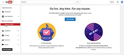

Well, I've unboxed the Matrox Monarch HDX and then managed to have an insanely busy week. This is always a tragedy when you've got brand spanking new gear that is begging to be used for the first time.
So, I've lobbed in to my YouTube account and clicked on the "Stream now (beta)" option in the navigation menu on the left. What is then revealed is this:

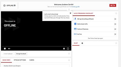

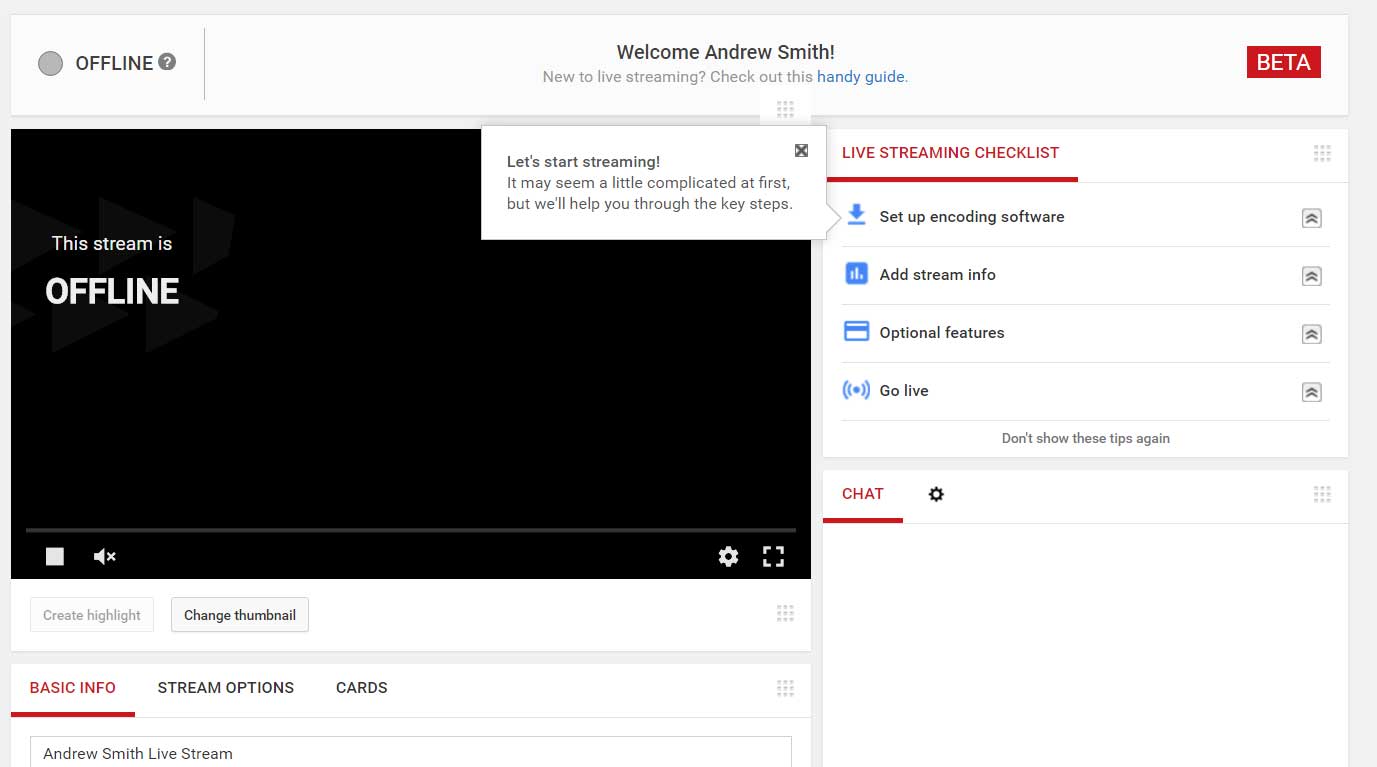

Clicking on the button to get started, you then come through to the obligatory paragraph of legalese.
The good news is that the helpful people have bolded the text that you want to see, enabling you to get through to the important stuff straight away. Essentially, you hereby promise that you have all permissions required for whatever content you put out there through your live stream.
Your account must also be verified, of which mine already was so that I could post content longer than 15 minutes.
From the initial view of the interface, it looks like YouTube has put a bit of work in to this, with a clear enough check-list that has been created for us first time users.
Getting going with your first YouTube live stream-start-ui-streaming-youtube.jpg

The first item in their helpful list was to set up the encoding software for the stream. YouTube at this stage seems to be set up with domestic users in mind and has 'live verified' software encoder titles that people can use.
You can see a list of the software apps here: https://support.google.com/youtube/answer/2907883?hl=en
The list includes a link to the very impressive Open Broadcaster software which I've had excellent success with simply for its ability to do a recording of a desktop screen during a presentation. The finished file worked in seamlessly with editing on Premiere Pro CS6.
The rest of the tips on the top right corner are pretty much what you could have guessed by looking at the rest of the interface. Put a title in, select options for your stream, go live, yada yada yada.
Under the stream info section (name and description fields) there is what looks like the truly important content that we are after. It's the "ENCODER SETUP" area with the server URL to point your encoder at and a "stream name/key."

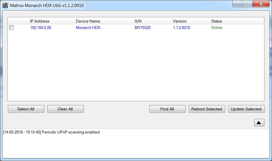

So, I've plugged in the Monarch HDX and it's done the Christmas lights / party lights flashy thing as it boots up internally. Of course, it goes without saying that even more developer time went in to the rest of the product than just the flashy light sequence.
Worth noting is that this is professional equipment. There's no physical on-off switch like domestic appliances have. The power lead is either connected and on ... or it isn't. This also makes switching off the unit a very simple exercise than any three year old can do without risk of offending, say, the embedded operating system - especially if it means you can watch the flashy light sequence again.
So once the unit is started up, you can then run the super-handy "MonarchHDXUtils" app that does a quick scan of the network and lists all of your Monarch streaming devices.
The good thing is that this solves the next question of "what IP address did the DCHP on this network assign to the device?" now that I need to talk to it via a web browser.
The bad thing is that these things are $3k (Aussie dollars) each and I've only got one of them, whereas you could have at least half a dozen listed here with space to spare. Slightly crushing to the ego.
This reminds me of when I was ordering the unit and asking about delivery time. The guy checked with the supplier/warehouse and announced "They've got two in stock!" to which I replied "Fantastic! I just need one!" Well, it was funny at the time.
Here below is the interface of the MonarchHDXUtils app. You can click any of the blue text and it will launch a web browser window and point it to your device. It can also update your firmware directly from the internet, which is also very handy.
