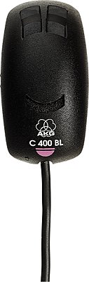

Hi Guys
Had a tricky one today at an Arts Festival where we had 13 kids on stage reading from scripts (they attended a theatre workshop 30 minutes prior to going on stage) so it was basically whispers and heads down and no voice projection at all. The venue decided not to supply any audio so it was up to us to try and capture audio from all these kids (speaking in turn)
I decided eventually to use two AKG boundary mics mounted about 6" in from the front edge of the stage and spaced about 15' apart but the audio was OK but not brilliant ... Would you have done it any other way? The kids were around 15' from the front of the stage so I felt that shotguns left and right wouldn't have been any better.
Any hints from those who have had no desk feed and had to provide their own audio capture??

To be honest I have no idea what the pickup pattern is on both mics They are AKG C400BL units and are neat due to their size (really tiny at about 1.5" x 3/4") This was a permanent timber stage and the kids were basically spread out in a rectangle around the centre but did move around and come on and off stage frequently. I just used a layer of my cloth gaffer tape between the mic and floor and it seemed to soften the footsteps pretty well. I was wondering if a boundary mic would work better with equal floor area them? I had them quite close to the front edge of the stage and was wondering if they would have been more effective if I had moved then say 3' from the front edge of the stage instead of 6"
Yep I was broadcasting out with one mic to left channel and one to right via transmitters and thru my XLR 2 channel mixer and then HDMI from camera to my LiveStream Broadcaster which was being used as a wireless remote camera to the switcher.
If you are placing mics into two audio channels is it best to have them spread over the width of the stage or close together??

The stage wasn't that big around 30' wide and 15' deep so I had each mic about 1/3rd of the way in from each end so they were probably 20' apart. The only mistake I made was I should have pinned them in position using a strip of cloth tape just over the cable and on one I accidentally ran the tape over the top which muffled the output on the left hand mic. How do you keep yours in position without them moving around on the floor? I most definately had a much lower output from the left hand mic!

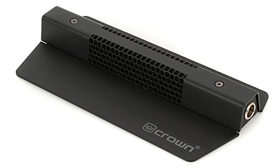

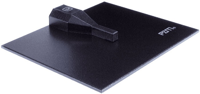

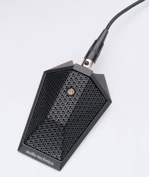

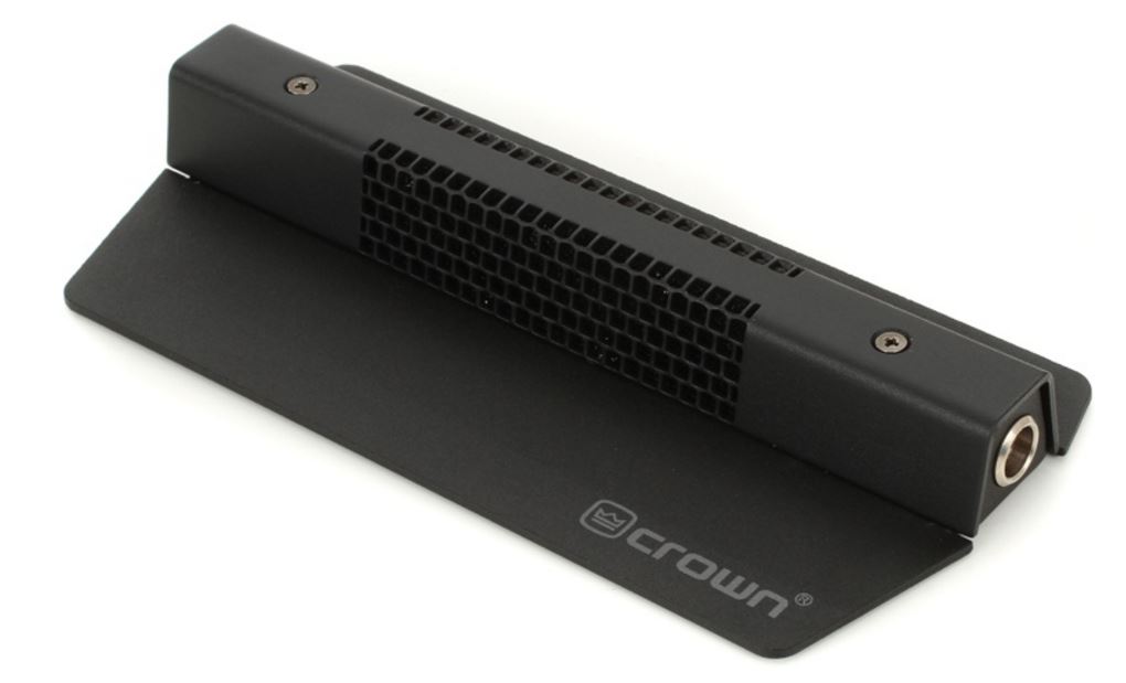

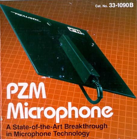

All of my Audio-Technica and Crown boundary mics have some flat surface near the edge of the body to apply a thin strip of gaffers tape to hold them to the surface. I don't have any round or curved boundary mics like your AKG.
The supercardioid and omni Crown's are especially easy as they have totally flat plates as their bases. (I forgot about my first mics, two classic Radio Shack PZM's licensed from a Crown design. They also have flat plates and are fairly heavy as I had one fall off a wall that had heavily textured wallpaper that wouldn't hold tape very well. Yes, you can put boundary mics on vertical surfaces if the angle and mic pattern are aimed at your source and that's your only choice.)
The AT's are a little harder since the edge is narrow, but it's enough as long as nobody kicks one.

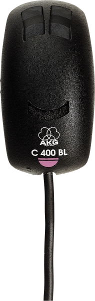

All the comments are appreciated. Yeah the C400's are tiny but effective ,,, I'm wondering if I should give each of them a small aluminium plate so I can tape them down using a base plate ..I really messed up on one mic on Saturday when tape covered the unit so maybe a neat plate glued to the underside will be an idea and provide easy fixing in future. You can see how tiny the AKG units are. They look like a tiny computer mouse actually but no lip around the housing at all to tape it down unless of course I just apply a strip of double sided tape to the base prior to leaving and then just "peel 'n stick"

I like that cos it also provides a cushioning between the mic and the floor so it won't pick up so much noise caused by heavy foot stomping. I used a couple of layers of cloth gaffer tape as the cushion but on the one mic I made the mistake of covering some of the vents on top which attentuated the audio somewhat so I had to use the left hand channel only. We some something quite similar here in the hardware store but I have a feeling it won't come off as cleanly as the Black Tak! I wonder if mirror mounting tape would work too? That has a foam layer with adhesive either side ...using mainly for mirror mounting ... the foam does start to fall to bits over years but it's only going to be stuck on the underside of the mic for a few hours and would provide a buffer layer for floor mounted mics.
