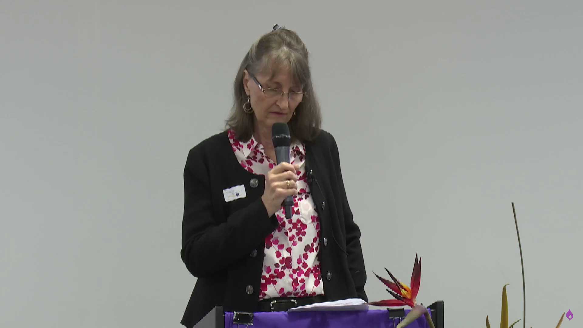

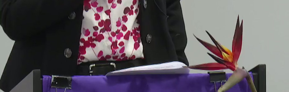

And our nomination for "worst up-res of the year" goes to .... YouTube.
(click to enlarge images)
Andrew
YouTube now determines what max resolution your stream will be-streaming-1080-frame.jpg   YouTube now determines what max resolution your stream will be-streaming-1080-frame-detail.jpg

Looks like they aren't de-interlacing. They're usually good with that cause the major networks for live news on YT pipe their direct 1080i TS feeds with embedded closed captioning just fine...

I was shooting in 25P and the feed to the encoder was coming from the camera via SDI to the Matrox Monarch encoder (which will intelligently deinterlace if needed). Not an interlacing / deinterlacing issue.

It could be 100% possible your 1080i output from your SDI port is not sending PsF but rather 1 field from progressive frame 1, then 1 field from the next frame. The sawtoothing looks too clean to be Youtube's fault.

If it was that then I reckon it would show up at the other resolutions.
