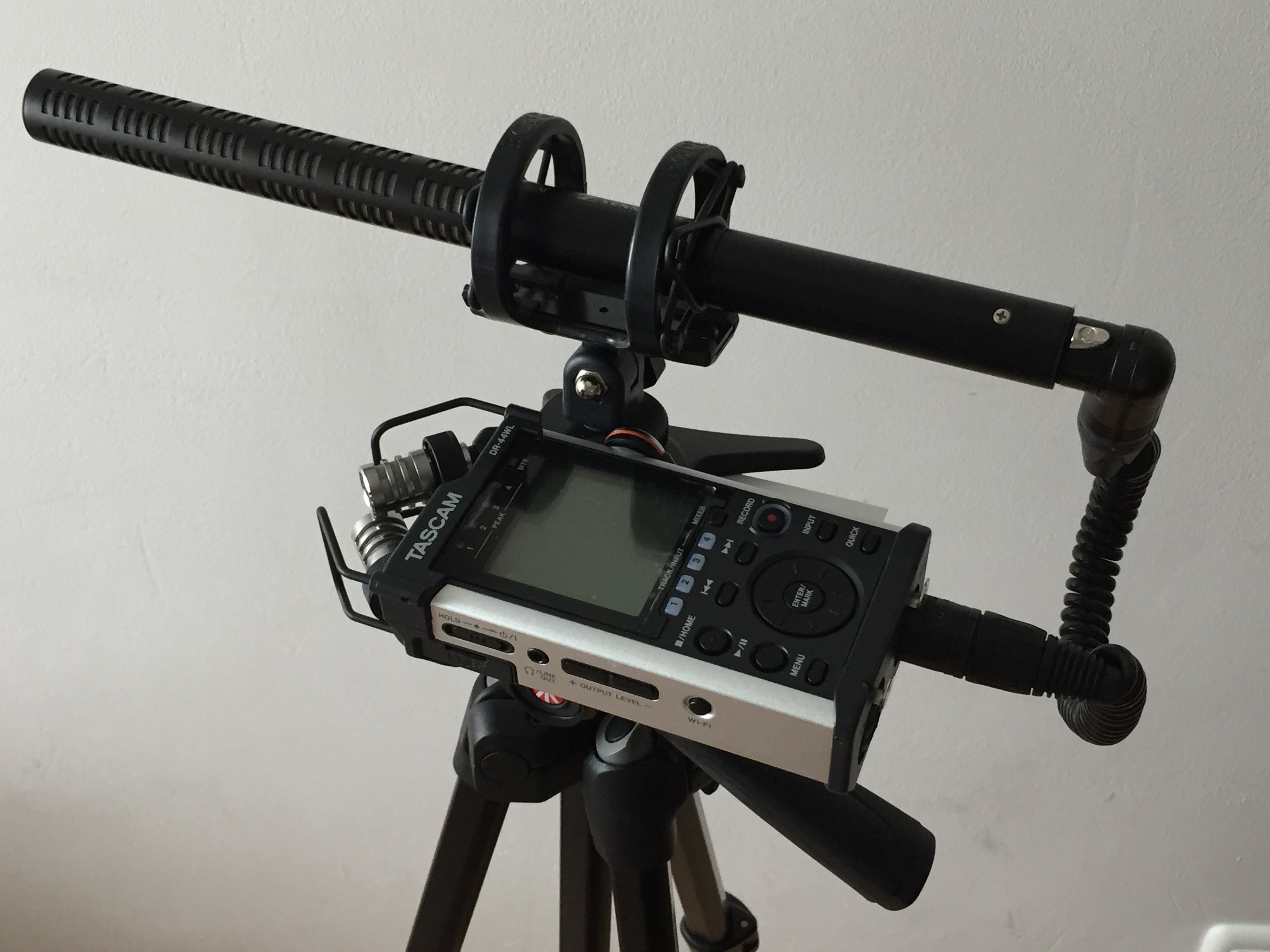

One option is to set up a stand with your own mic near the stage. A couple weeks ago I did this at an outdoor wedding (not a stage, though) and the audio was fantastic, nice and clean. Used a Tascam DR-44WL recorder connected to a Sennheiser ME-66 shotgun mic and not only was the setup clean but the audio was as well. The 44WL is Wi-Fi controllable with On/ Off, and gain on both the recording channels (individually) as well as the two safety tracks. There is an app for the iPhone and perhaps for the other ones, too. Much more audio control than the PA system and one doesn’t have to rely on anyone else.

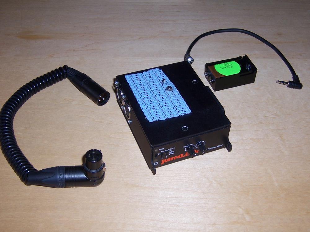

The other option is to use a preamp. I’ve used the JuicedLink pre for several years and it has a reputation for clean audio and a clean noise floor. On the lowly CX211 there are two XLR inputs, mini input, and separate controls. Would require cable to run to it though.

[edit: the above page link is on the dvinfo web site but don't know if it is accessible without logging in. Here is another link DV Info Net to a picture also on the web page, but ditto above. Attached a picture of the CX211]

Made up a small plate to mount the recorder on using a plastic 4-square electrical box cover plate and a 1/4" screw. On the tripod side, the plastic plate was thin enough to fit between the mic and the quick-release plate.
