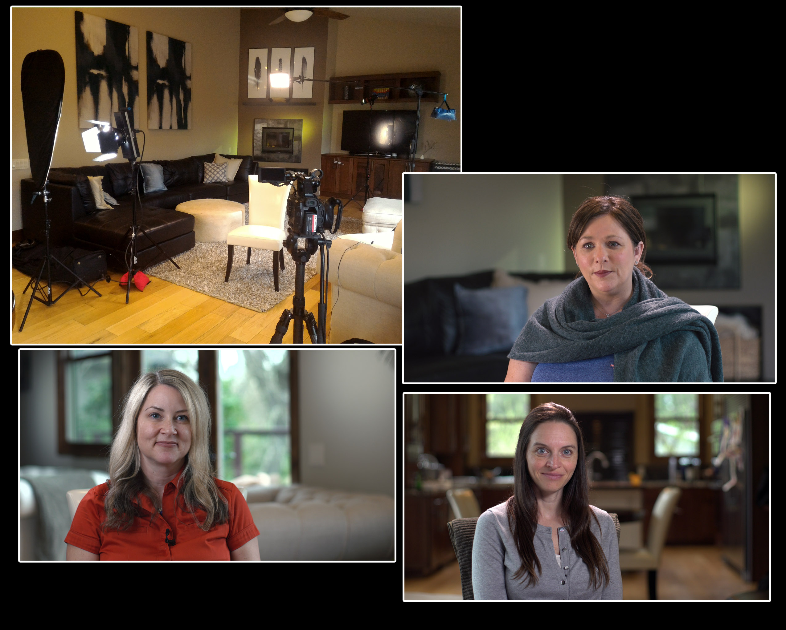

I do these somewhat regularly, and take a more involved route with the lighting. It's possible to do, but you really need to have a plan going in and allow yourself enough time to juggle everything.The toughest part is having to split your attention between the shot and the interview, maintaining eye contact with your talent while monitoring your audio levels and ensuring that your shot is still well framed and focused. Your best bet is to add an accessory monitor on a stand just in front and below your line of sight to your talent. But barring that, position yourself just to the side of the camera, allowing your talent to look you in the eye, but being able to see the shot in your periphery and glance over occasionally when you can. I like doing these in 4K with a lock-down shot and zooming in post. Side angle is great when you have the time for it, but you'll have a hard time monitoring it while it's rolling.
A rather inexpensive suggestion is to hire a PA to help with the setup, and ask the questions during the interview. Costs in my area range from $15-30/hour. Not much to add to your cost.
