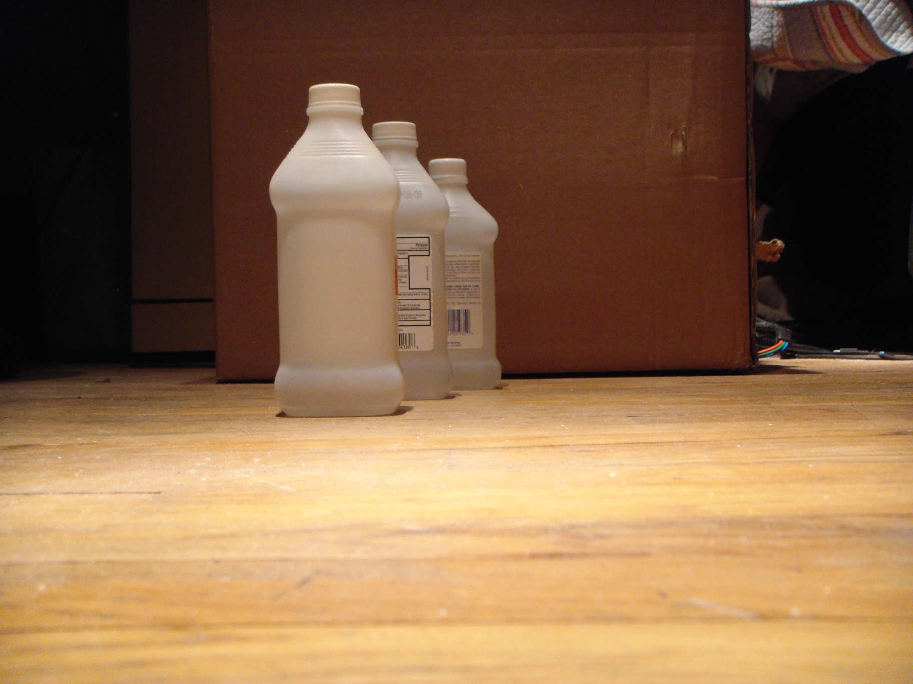

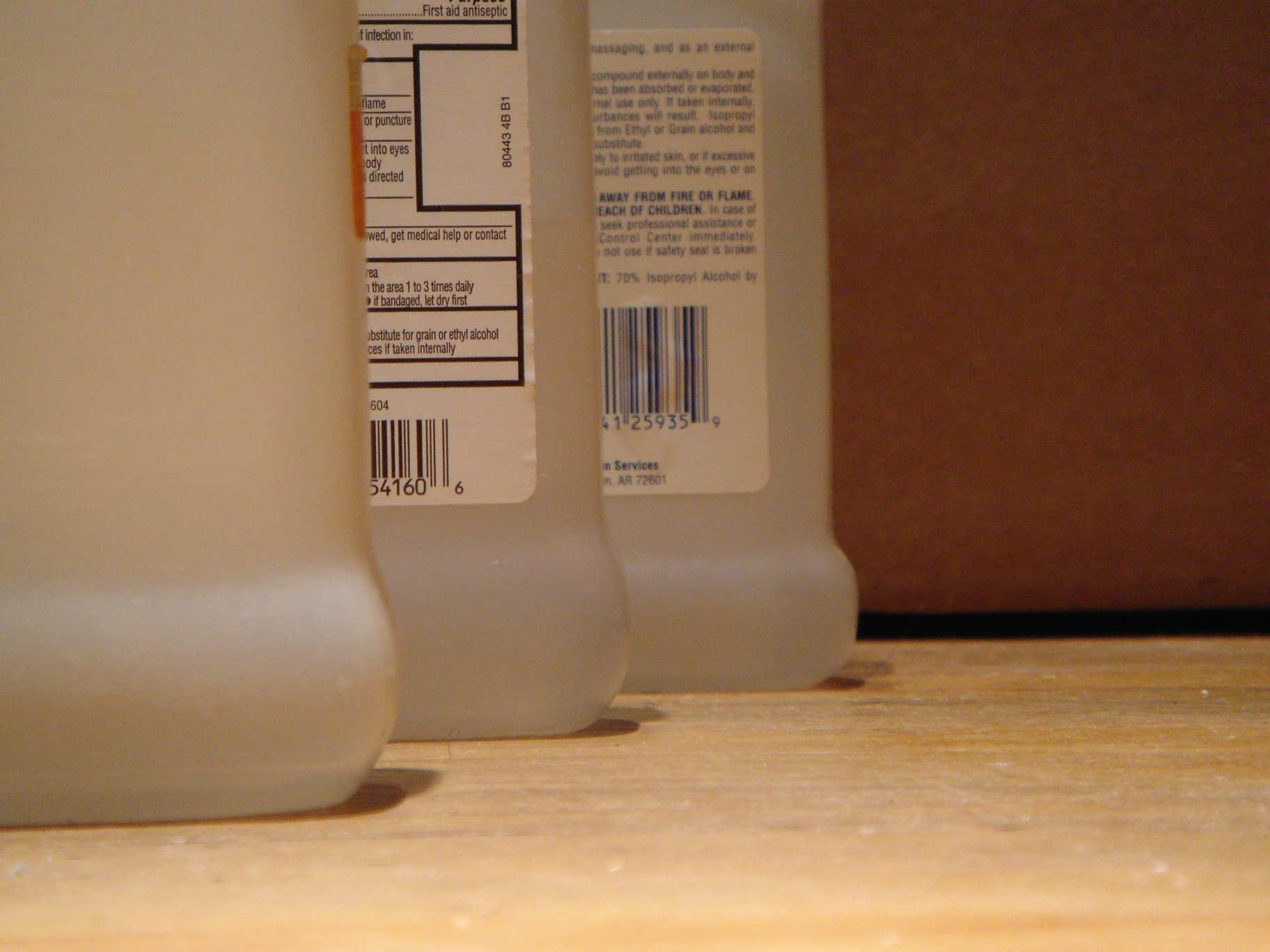

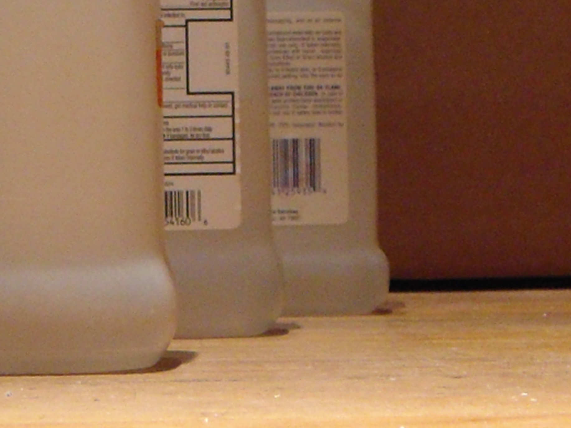

Yes, Jacques, that's exactly what I'm saying, and I only now realize I neglected to offer that exercise in my explanations. That's one of the photo sets presented in the Digital Compositing book, as a matter of fact.
With the camera locked down, in one location, shoot both a wide angle and telephoto shot of a subject, something that will adequately exhibit compression (the columns mentioned would be perfect). When you compare these two in a computer, the initial impression may be that the telephoto shot is the only one that's compressed, but that's not the case. Crop the wideangle shot to match the telephoto one, blow it up to the same size, and the perspective will match.
I have no samples on hand, but if you give me a few minutes I'll grab a few shots and upload them. Hold tight, I'll be right back.
UPDATE
Here you go! Please excuse the dirt, I haven't vacuumed this room recently. Give me a break, I'm a guy.
I arranged three bottles of rubbing alcohol I had handy in a staggered line in front of a cardboard box, with a bit of space between each of them. Setting my camera on the floor, I took one photo at full wide, and another at full telephoto (for curious parties, on my Cybershot T500 the 35mm equivalent angles come out to 33 and 165 millimeters, respectively). The camera did not move.
Comparing the originals may make the telephoto shot seem compressed at first, but look at the third file I uploaded; this is the first photo, the wide angle, simply cropped in Paint Shop Pro to match the framing of the telephoto picture as closely as I could, then resized to match the other two images' dimensions. Though the resolution differs, you can see how even though the focal length changed, the perspective did not, and the perceived distance between the objects is the same in both photos.
How is this effect done?-wideangle-original.jpg   How is this effect done?-telephoto-original.jpg
