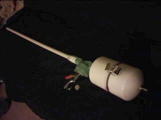

Hi. I will be DPing, starting in January, it looks like, a short film involving some gunplay. We have several characters getting shot, and would like to have bullet hits/blood. My friend, the director, had planned to try out squibs but has abandoned that idea.
He has built a "goo gun", basically same idea as a paintball gun, potato gun, tshirt cannon. It is an air tank hooked up to a valve with a trigger release, which is then hooked up to a barrel made of a PVC pipe. You cram your ammo/goo/blood into the barrel, manually pump (we use a simple bike pump) the air tank up (I can only get it to 30 psi before it starts to become impossible to pump further), and use the trigger to fire.
The idea is that if the goo/blood hits the person fast enough, it appears to just "appear" there, like a bullet hit, instead of being shot onto them.
We have tested it with mostly lackluster results.
We need to have several pistol hits, and maybe a shotgun hit. So far, even with the tip of the barrel at four feet away from the subject (far enough to be outside of frame on an MCU of a character), we're still getting too much spread/spatter, instead of a concentrated area of impact.
Let me tell you what we/I have tried so far.
We started just simply pouring our "blood" into the barrel. . .corn syrup and food coloring with chunks of banana mixed in.
I have tried a new mixture he come up with that was based on mashed up avocados. a neighbor who knows guns/ballistics to some degree advised putting something behind the goo (i.e. first thing into the barrel, before the goo), like a cotton ball, facial pad, pineapple core, etc., to ensure that the air hits a solid surface at the same time. So far these devices have stuck to the goo all the way to impact, resulting in a splat with a cotton ball in the middle.
I tried my own idea which was wet and torn up toilet paper, which gave a more concentrated mass, and the cotton balls, etc., did not stick, but still flew too far.
Anyway. . .using this device, any ideas to make it better? I should mention that I haven't had anything long enough to tamp the mass of goo and cotton all the way down compactly, as the tamping devices I was given fall 3 or 4 inches short of the length of the barrel.
I've attached a hastily taken photo of this gun.
on the left is the long barrel. . .about 38". The green part is the valve, see the trigger (red) on the bottom, and the air tank with pressure gauge at the back.

One method is to use a water balloon or similarly shaped latex container (red or white/flesh colored), fill with blood mix, tie shut with a bit of pressure, and then shoot with either an airgun or slingshot. In post, edit out the frame immediately before the hit (when the projectile will likely be visible).

if you want accurate shot, you need accurate bullet.
Most of them are made of solidified jelly. you need to find a mold that is just big as the tube and make a jelly enveloppe, eventually filled with liquid or jelly.
So made, the jelly keep relative shape until hitting the target, while being soft enough to avoid injury or being as a visible bullet.

with the balloon---tail (open end of balloon) goes in the back of the barrel?
How does this mold thing work? Is this something one can do oneself or does it require special tools? I'm not clear on what you mean.

Neighbor suggested actual paintballs. Why not? Barrel is 1/2" PVC.
Any other ideas that are totally different from this goo gun idea? We're already aware of the idea of filling condoms with goo, cutting a slit in it, and using fishing line to pull the hole open at the right moment.
Others?

actual paintballs bullet (if received one already are painfull, the envellope is really hard).
fo rjelly , there is two types, the ard/dry one and the soft/wet one.
The hard/dry one is the same on can find in these little jelly teddy bear.
you can dissolve some in hot water and use a thin layer to build the bullet envellope)
Pro: you can keep them for a long time, con: they are a bit harder.
the 2nd type is made from real jelly (animal or vegetal) you can find under sheet or powder in almost any kitchen. You dissolve the product in hot water and then simply fill the mold.
Pro: probably easier to build, con: they dry very fast (amost 95% of the jello is water)
you can even make a mix of both , very liquid jello surrounded by a thinh layer of hard jello.
for the mold , you cand find a small plastic bullet (like the one you find is distributor in supermarket, a little ball that contains a toy), it is about 1 " dia.
you can make a mold with silicon, that will be easier to unmold.

I'll have to read that a few more times about the jelly mold thing but I think I understand.
Real paintballs were the next idea. Went to Academy and they didn't have anything smaller than a 500 count for $15, which I didn't feel like getting. that size was maybe a little small (1/2" PVC barrel opening is about 5/8", and the .50 cal paintballs looked to be not quite 1/2".)
I wonder if this is the wrong approach, then? Shooting the goo onto someone as opposed to finding a safe and convincing way to have it come FROM them. Seems like with the shooting eyes/face are always in danger, even if you padded the area for the hit (torso).
